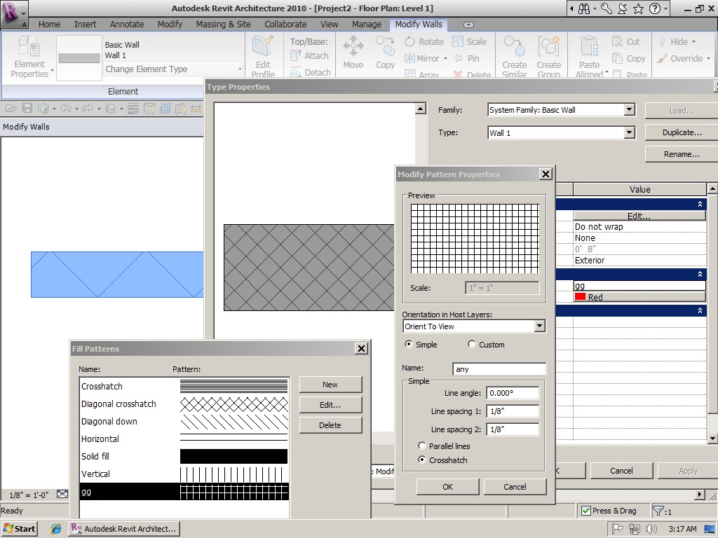

i tried everything i can think of to
get control of the wall assembly
hatch pattern in floor plan view..
how do i do it?

i mean make the wall assembly
show the hatch patterns i choose..
look at the image i posted and see
all the attemps i am making to try
and change the hatch pattern..
Mon, Dec 14, 2009 at 7:46:59 AM | Wall assembly hatch patterns
In the screenshot you show, you are setting a pattern for the wall in coarse views.  This is not a material setting.  To set hatch aptterns for materials, you need to edit the wall definition and set it ther.  Wall material hatch patterns do not show in coarse views.
