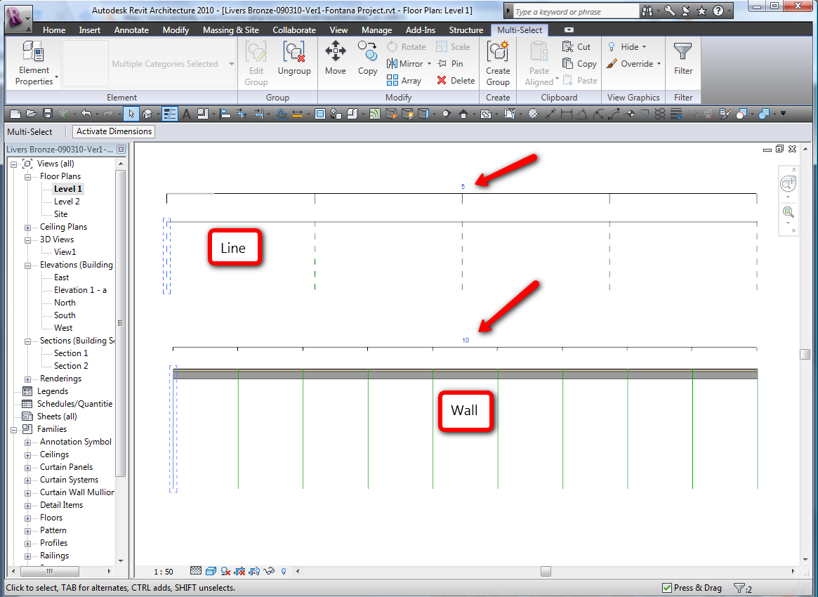

how to divide a line or object in equal parts?  dor example divide a line or a wall ...  similar to divide in autocad?
Fri, Dec 11, 2009 at 9:41:22 AM | how to divide a line or object in equal parts?
GRINHEART
GRINHEART Avatar
Joined: Fri, Jun 12, 2009
157 Posts
4 Stars: 5 Votes
Use the Split tool and/or Dimension them and use the EQual.

Use the "Array" Tool....

The array tool can do it, as I've just tested, but it involves adding more lines as is less efficient.
The OP didn't really get the answer of:
  1. create a detail line
  2. use the array too and select 'last' instead of '2nd' (that's the clincher)
  3. move the distance you want to divide
  4. select the number of arrayed objects you'd like
