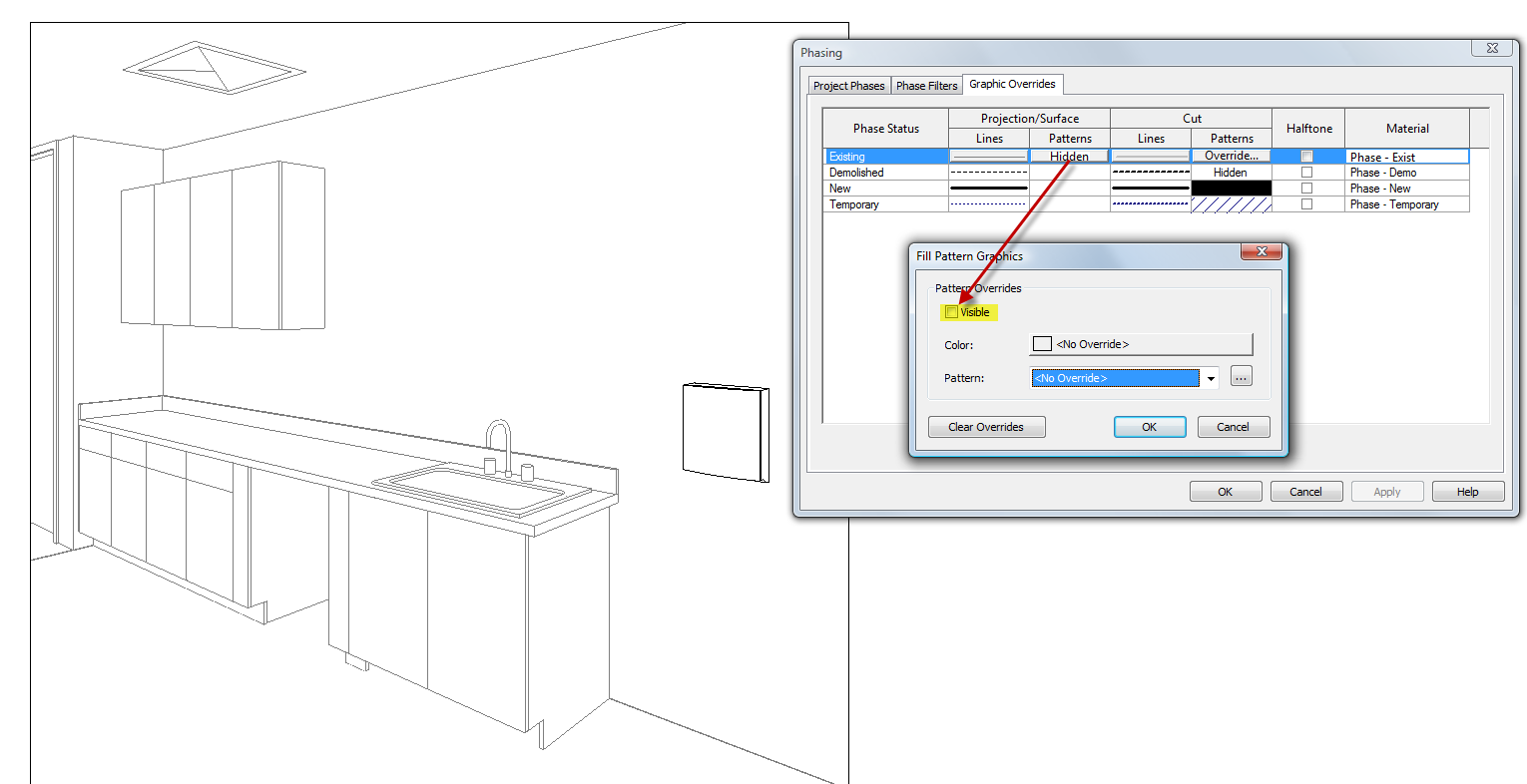

I'd like just the new walls to have a visible surface pattern and the existing walls to be blank.  Is it possible to control wall surface patterns by phase?
Thanks

Yes.  Go to Manage-->Phases-->Phase Filters
Then set the projection pattern override for existing phases to not be visible.
HTH.

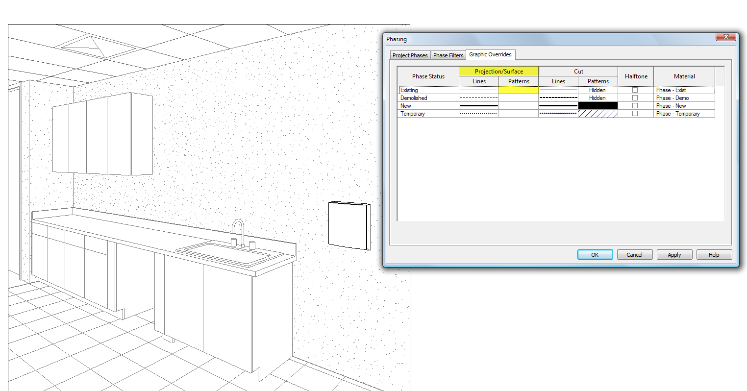

 Don't you mean "Graphic Overrides" Tab not "Phase Filters"?  If I uncheck the "Visible" box, then the floor and T-Bar ceiling grid patterns also disappear which is a problem... I just want to turn off the existing and just the wall surface patterns to differentiate between new and existing walls....
See the attachments
69915_12-8-2009_Existing_Wall_Surface_Patterns-Off.png69915_12-8-2009_Existing_Wall_Surface_Patterns-On.png
