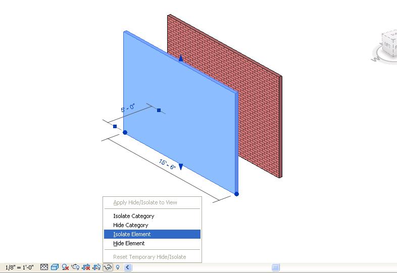

We recently installed the 2010 service pack that reformated the method of modifying keyboard shortcuts to a searchable, live edition within Revit.  I overall really enjoy the change, and have updated most of my frequently used shortcuts, but I can't find the isolate element command (the button is on the View Control Bar at the bottom under the sunglasses icon).  Hopefully I am just missing something here.  Has anyone else noticed this?

Pavan
Pavan Avatar
Joined: Sat, Mar 19, 2005
157 Posts
4.5 Stars: 3 Votes
It is there on view control bar itself, check the attachment. Also HI is the shortcut.

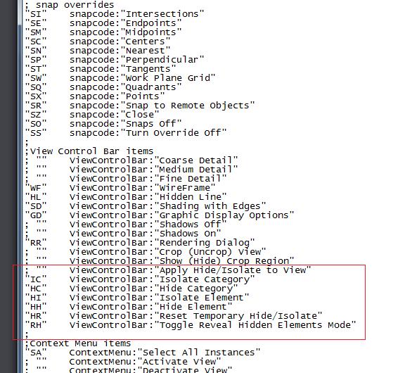

tim123
Joined: Tue, Apr 12, 2005
1310 Posts
4 Stars: 19 Votes
Not sure why you don't have it - see attached - it's under the 'View Control Bar items.

brettgoodchild
brettgoodchild Avatar
Joined: Sat, Feb 4, 2006
425 Posts
4 Stars: 17 Votes
the OP doesn't have it becuase they installed the Subscription Advantage Package.
There are a few problems with the SAP, missing commands included.
As Chris said...it's missing.
as a side note, I did try modifying the xml file and did get the command in the file....but I can't get Revit to recognize it.
