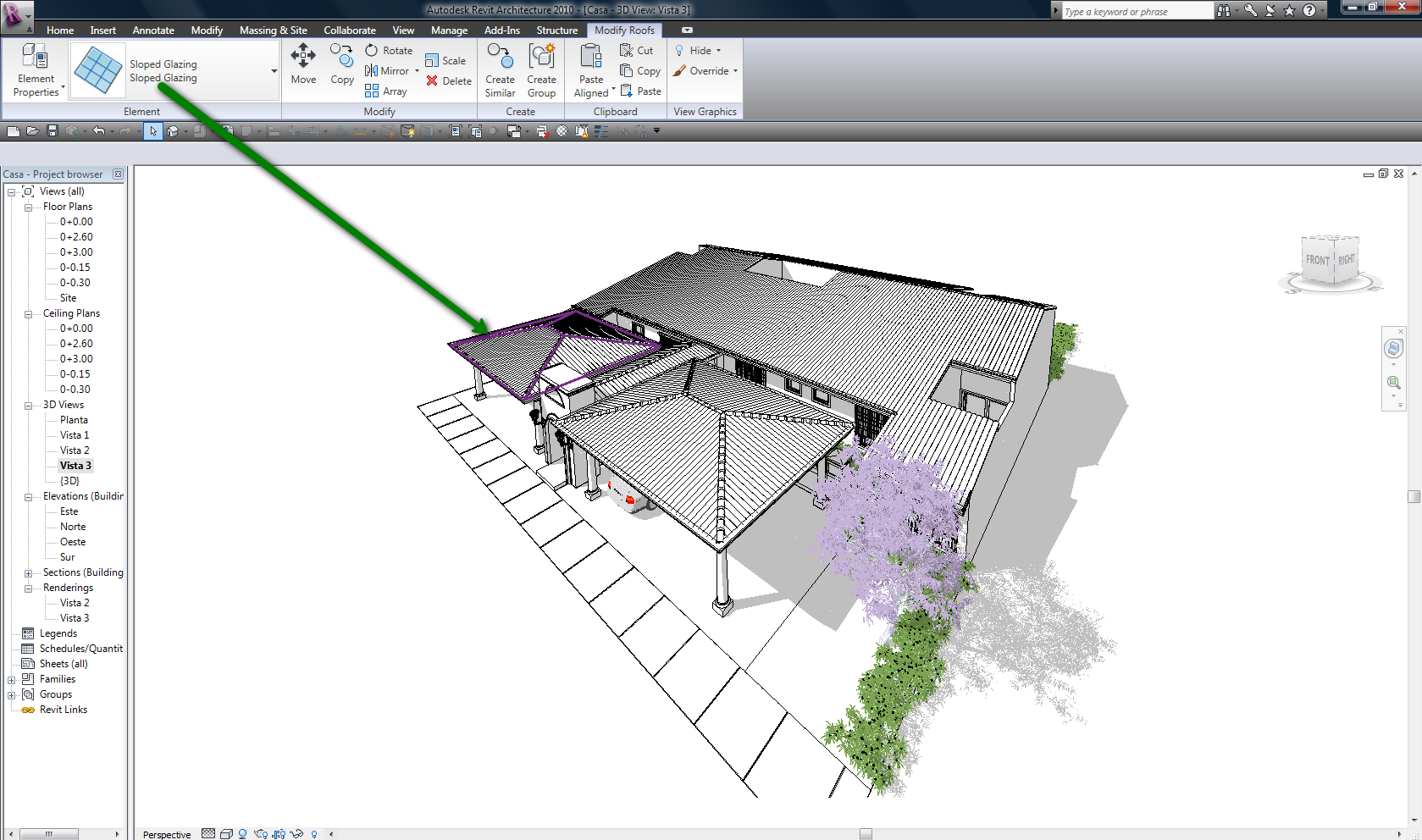

what I do is to create a sloped glazing and the profile of the roof I want....

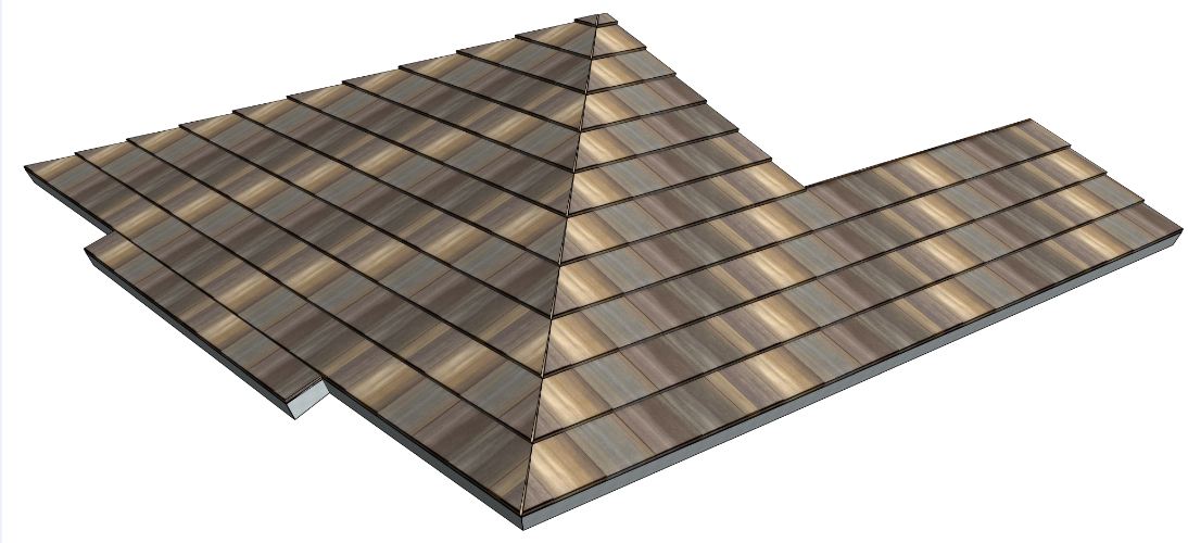

Hey I had a project where I needed to render these same tiles... I figured it out if you could still use the technique. Check out this family download: http://www.revitcity.com/downloads.php?action=view&object_id=11272 and read the description on how to do it. It's annoying but renders great.
