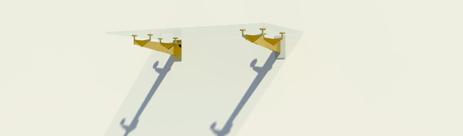

hi all,
i have a problem,
i created a family, i selected an item and added a modifier, a material modifier, saved it and loaded to a project, i opened the type, changed the material to a desired one and its ok, the problem that it dos not show in the render !, what did i miss, plz help,
thanks

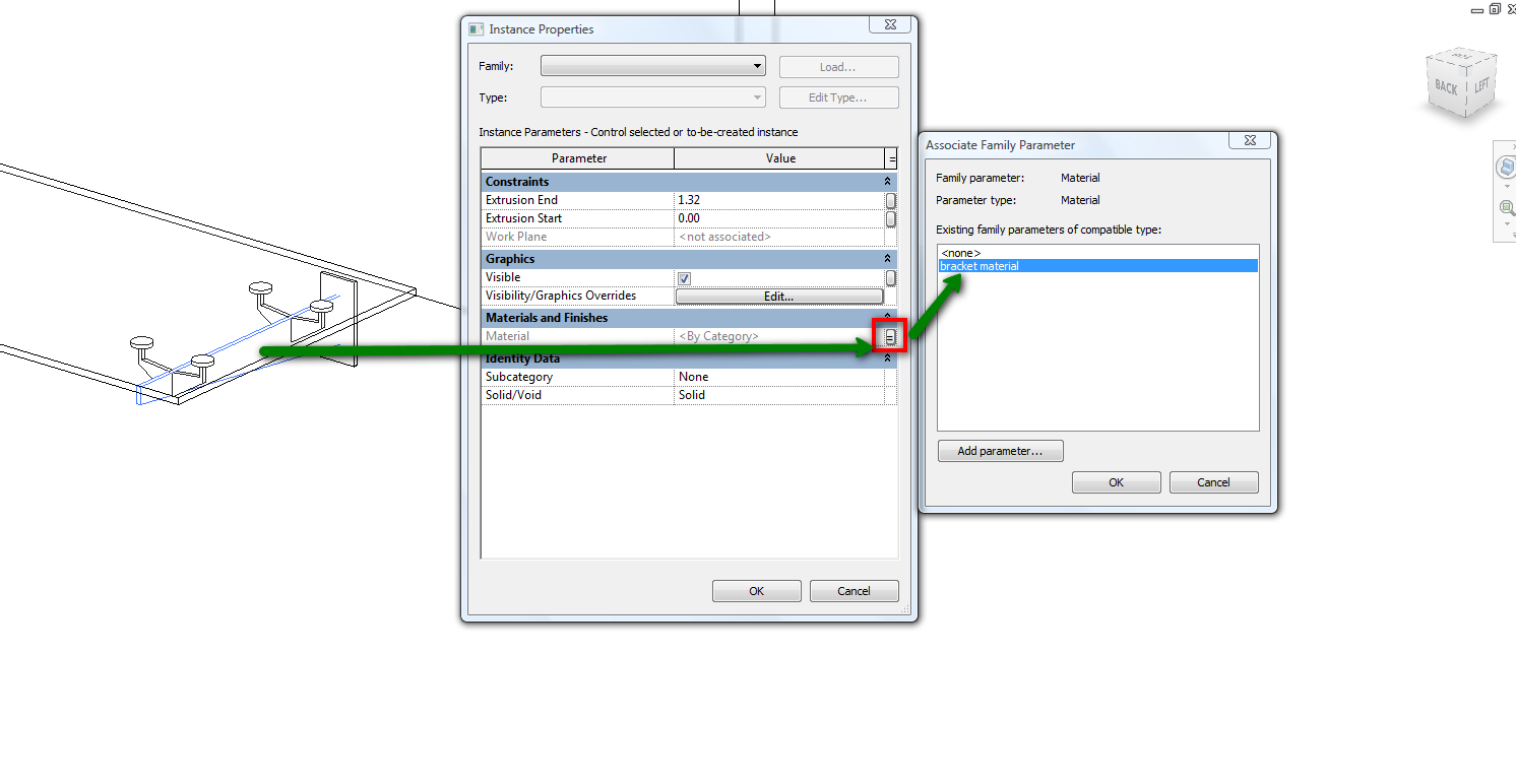

You have not assigned your material parameter to the brakets....

thx alot, i think i missed that.
