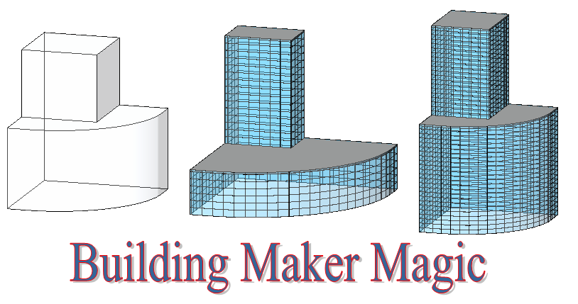

In the CADclip below I demonstrate the Magic of combining Parametric Massing Families with the awesome Building Maker Tools. This is precisely what Carl Bass pointed out in his keynote speech at AU 2009.
Then just go one step further and apply some material takeoffs and / or schedules and what used to take a huge amount of time, manpower, energy (and error checking) becomes 100% accurate and INSTANT !
Remember that REVIT stands for 'Revise Instantly' and that's exactly what this CADclip demonstates.
You call it REVIT . . . . I call it MAGIC !
If you are still using vector basec CAD instead of BIM (Building Information Modeling) do yourself a BIG favour. Grab a magic wand and follow me to Hogwarts School of REVIT Wizardry !
