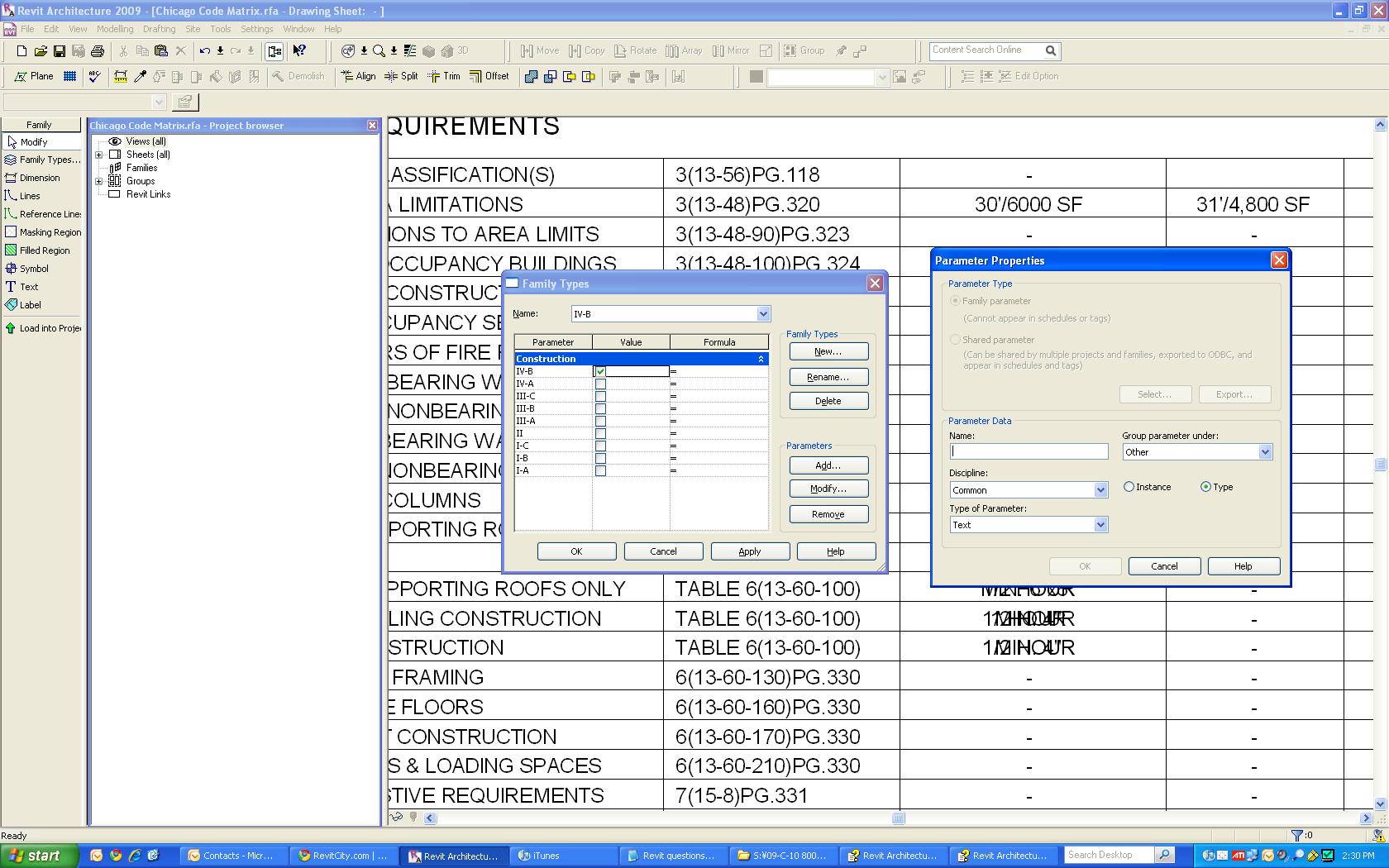

I'm trying to use shared parameters as a Family Type parameter to controle visibility of some elements.
As you can see in the screen shot, the part to select Family/Shared Parameter is grayed out and I can't 'Select' the Shared parameter I need.
Can someone kindly tell me why this is happening and how to solve it Please!!??
