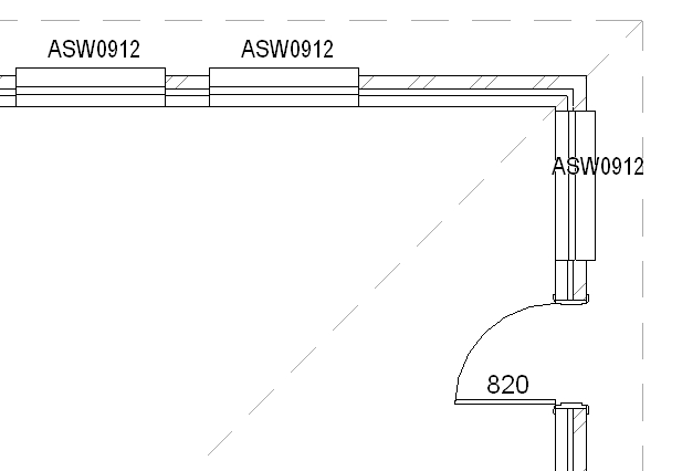

Im using revit 2009 architecture, starting at a new firm that is switching to revit from autocad. Ive been asked to make the templates, libraries for them etc. Matching the way they have been doing it in autocad.
 attached is a problem im having with a custom window tag, hoping someone here is able to help me with it..
 thanks!!

and what is the problem btw :p?
the tag works as it should with me,
showing the window type name.

problem i get is when i change the width of the window, the tag dosnt update. Also when i place windows vertically....the tag wont rotate Puh

Click on the tag - you have an option in the options bar for vertical or horizontal.

and you only been working with revit for two days i ques? Smile
if there is no Height and Width label in the window tag family, why would revit feel the need to update it?
open up the window tag family and add labels for the height and width?

Didnt want to insult you on the two days thing there, but if you would have looked into the Window tag family i would quess most of the tag editing would explaine itself,
i had a quick 1 min edit and its more or less done,
