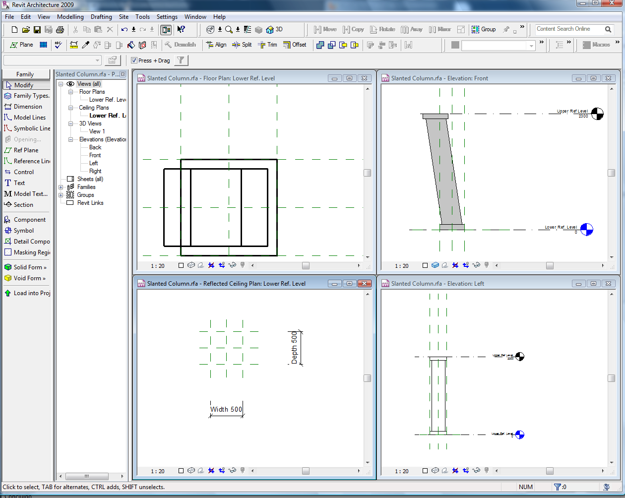

can anybody here knows how to create an inclined column?
please help me

Well, with a little of imagination i guess...
I don't know if this is what you want but....

thank you very much for the response, i think this is what i need, an inclined concrete column, i will check it.
for the meantime i use massing (sweep) just to produce inclined concrete column but i know massing is not exactly the right thing to do

Also you can create this by using the "Create In-Place" in the right category....
