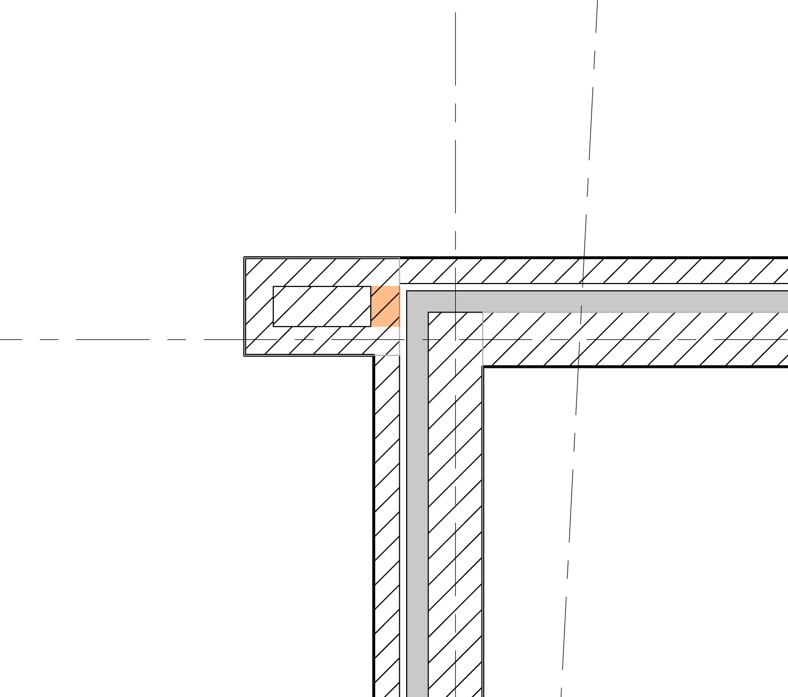

I am trying to create a nib wall, with brick on blocks.  i need it to wrap at one end and not at the other.  But I can only seem to get it to wrap at both end.  My setting is: finish 1 brick(wrap), core: block, finish 2 brick(no wrap).  At insert: do not wrap, at ends: exterior.
Is there anything I can do about this?

Sorry maybe I wasn't too clear with what i want.  I've tried joining/disjoining of all sorts.
 Please see attached jpg.  I want my block wall to extend to the part i have coloured orange.  I know I can mask it with detail fill, but if there is a way to make the model correctly it would be great.

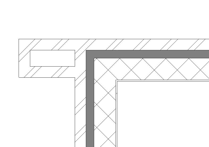

Do you mean like this?

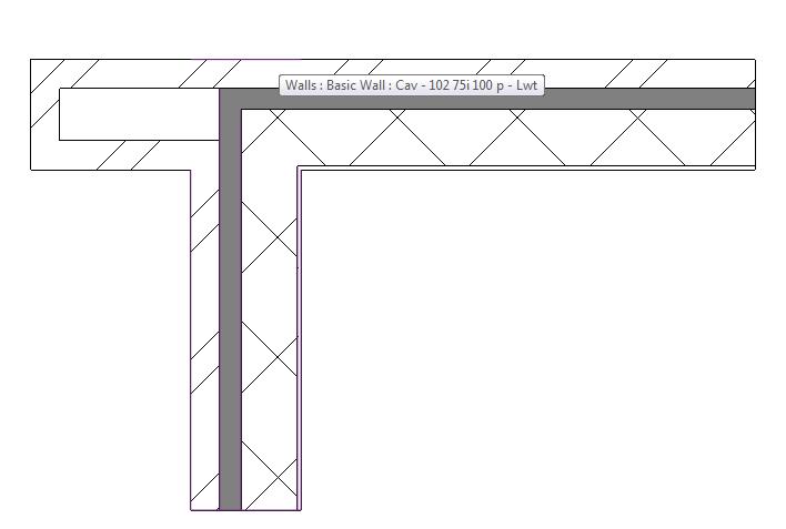

Or this?

the first one is exactly what i need.
So how do i get there?

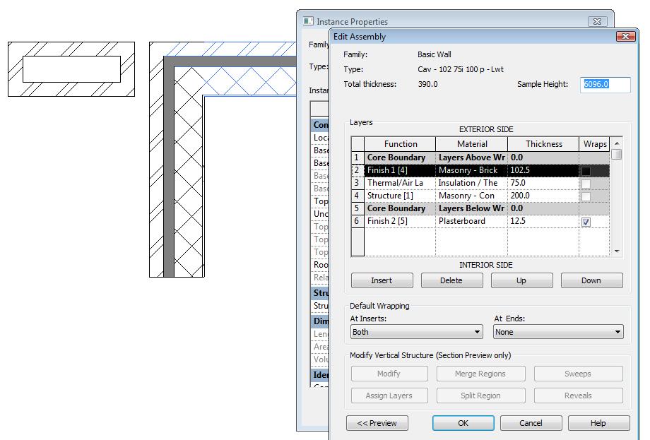

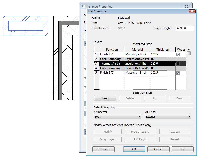

It consists of two wall types, shown in the two attached images.  Note the position of the layers in relation to the core boundaries.  I pulled them together, as shown in the image that I posted earlier (if the layers don't clean up properly at first, join the wall below the corner and move it up to the corner).

Missed the other image - here it is.
