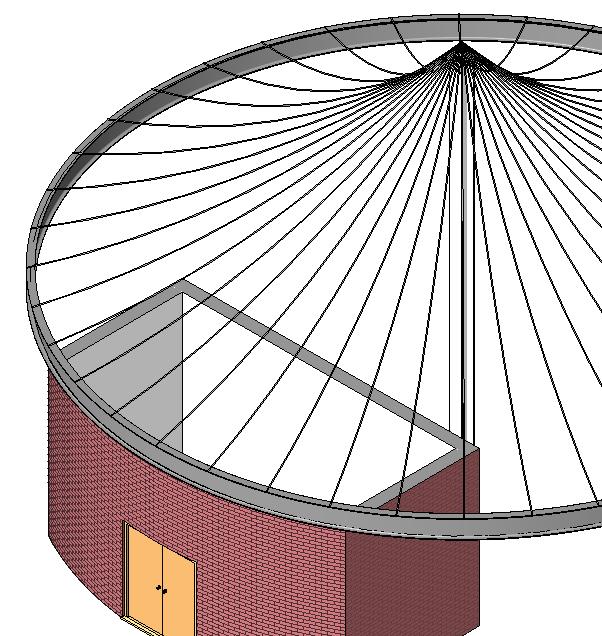

Sun, Dec 5, 2010 at 7:28:37 AM | circle beams
jsuarezn89
Joined: Wed, Mar 10, 2010
2 Posts
Hey TIM123!! How did u make that tensil structure. that one in the attached image... I need to do something similar
