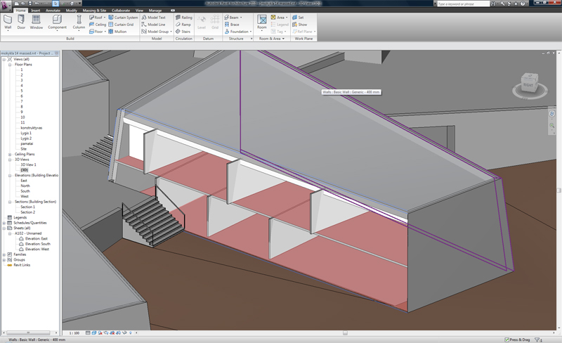

I just can't figure it out how to attach my vertical walls to a sloped wall Cryingwall by face) with a correct ending edge.

Simple, create a section view near of those Vertical Walls, then pick in the first and "Edit Profile", now you have your wall with 4 magenta lines, delete the line and create a new one with the right slope "touching" the sloped wall, repeat the same for the other walls...

Thanks for the idea, i've been using allign with profile editor aswell. But i want to know if there is any chance of making it adaptive so that everytime i edit my mass this wall edge would addapt automatically to the changes?

Just "Constrain" that line to that wall, Lock the padlock of that magenta line when you are in the sketch mode..
