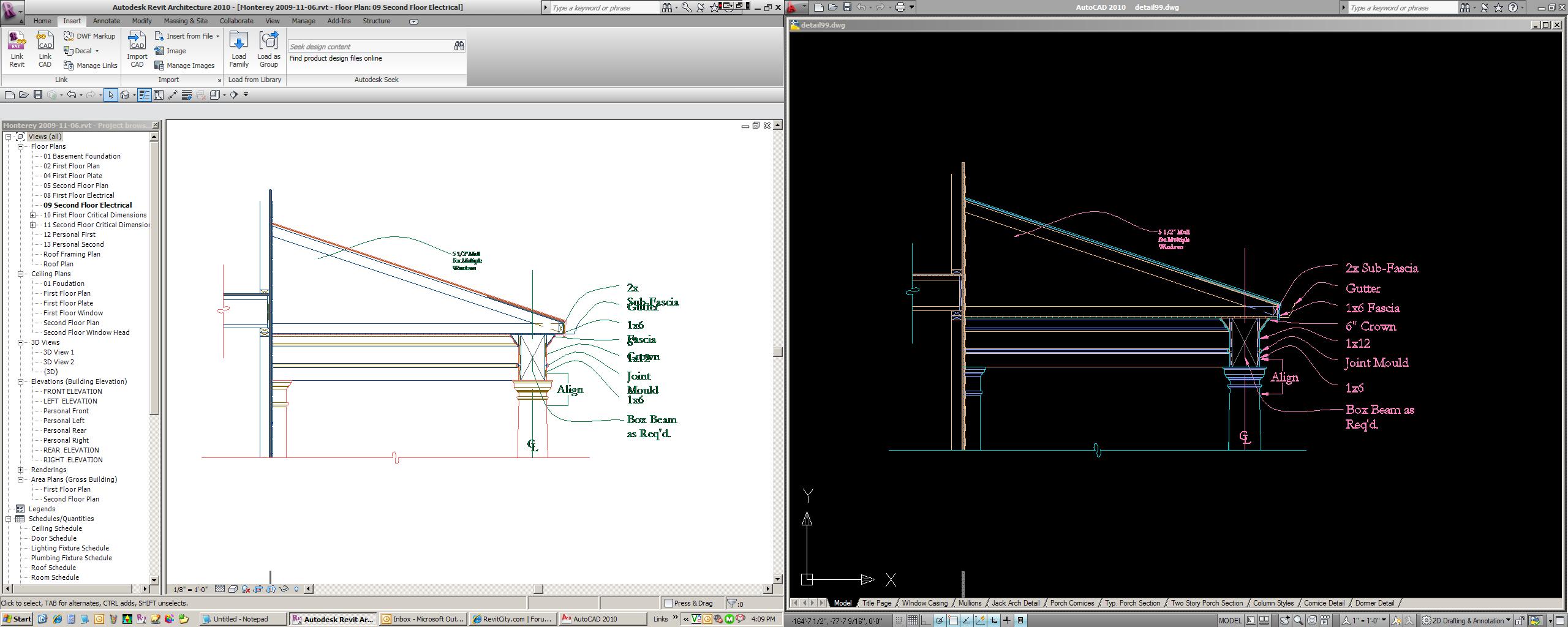

Hello,
We are new to Revit and are having trouble linking or importing our DWG details into Revit.  Linework is correct, but arrowheads are missing and text is becoming jumbled.  Please see attached files for reference.  Thanks in advance.

You will discover that imported and exploded CAD drawings is a BAD practice.  You really want to keep these to a minimum or not at all.  Linking is a much better process or better yet, clean up the detail in a junk REVIT project and then import.  Get rid of leaders - dimensions - hatch patterns and all polylines then revitize what's  laft.

Linking the CAD drawing has the same problem.  We have dozens of AutoCAD drawings which we assumed could easily link to Revit...  redrawing each CAD file in Revit is really the best solution?
