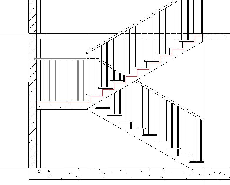

i want to draw a concrete stair but i want to see another material between treads and risers material and conctrete material.i ve added image.red line dosent exist i drawed it, i want to see that line as shows different materials in stairs.
there is a daub between concrete and stones so there must be line for it and a parameter for thickness.
what do you suggest  for it.

Does this really have to be modeled?  2D linework is my suggestion.

we can easily do this with structure option at floors why not at stairs.

Also, if you want to see another material between the concrete and the risers and treads why don't you use a "Filled Region" with the material you want?

indeed i am trying to solve this 3 dimentionaly.what if i change the place of section ,section changes then i ve to draw 2d linework again.i am looking for practial solution.it seems stairs didnt developed much more at details since 2009.

Something like this doesn't belong in the stair too.  If you want to model it, do it as an in-place extrusion.
