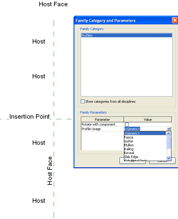

You have to set the profile usage in the family under settings / category and parameters.

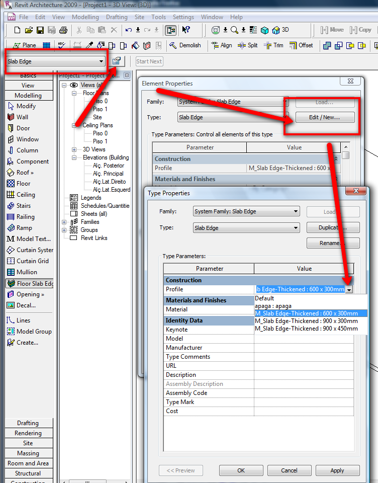

After you load into the project go to the Properties of the Slab Edge and change the profile...

aaaaahhhh...Thank you!
I'd been in that screen before, but not since my recent progress making the family changes.  That did it!

I know that, don't forget to "Duplicate" before that slab edge....
