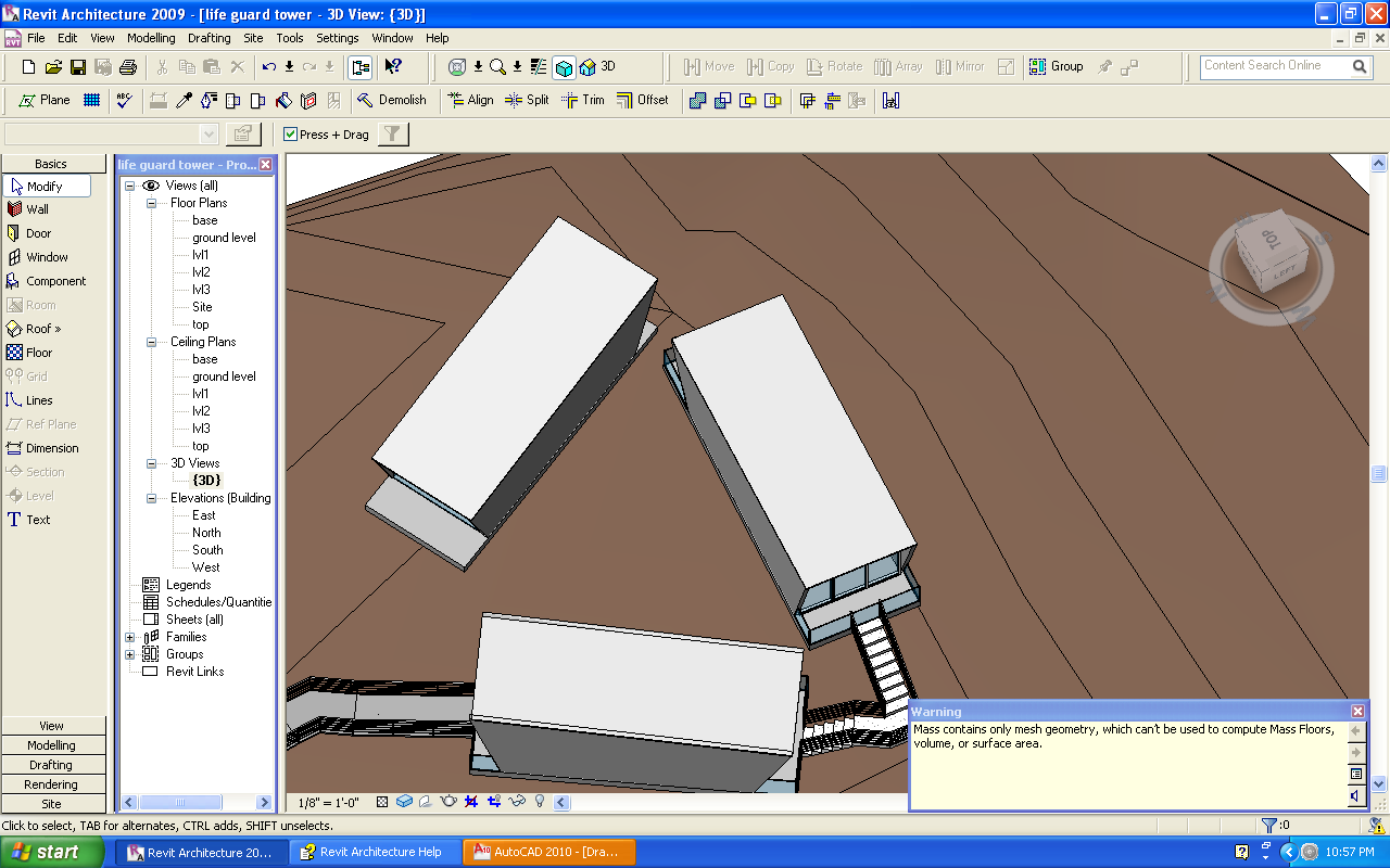

I imported curved form from rhino into revit by creating a massing in revit but when i click finish massing, revit showed that error. Can any experts help me out please. This is my last project for the class. Thanks in advance!

In Rhino you create that with "Mesh" and not with "Solids" that's why it gives that Warning....

okay. can you show me how to make it in solid form? cuz after that warning showed, the massing disappeared.

I don't have Rhino anymore, since Revit 2010 appears with the new Conceptual mass.... But i remember in Rhino you have A "Tab" for Meshes and other for Solids.....
BTW, see this video:  http://designreform.net/2008/07/rhino-autocad-revit-linking-complex-form-to-drive-massing/

yeah i already saw that but it didn't help. when i imported the massing form into revit. it shows me that warning like in the picture.
