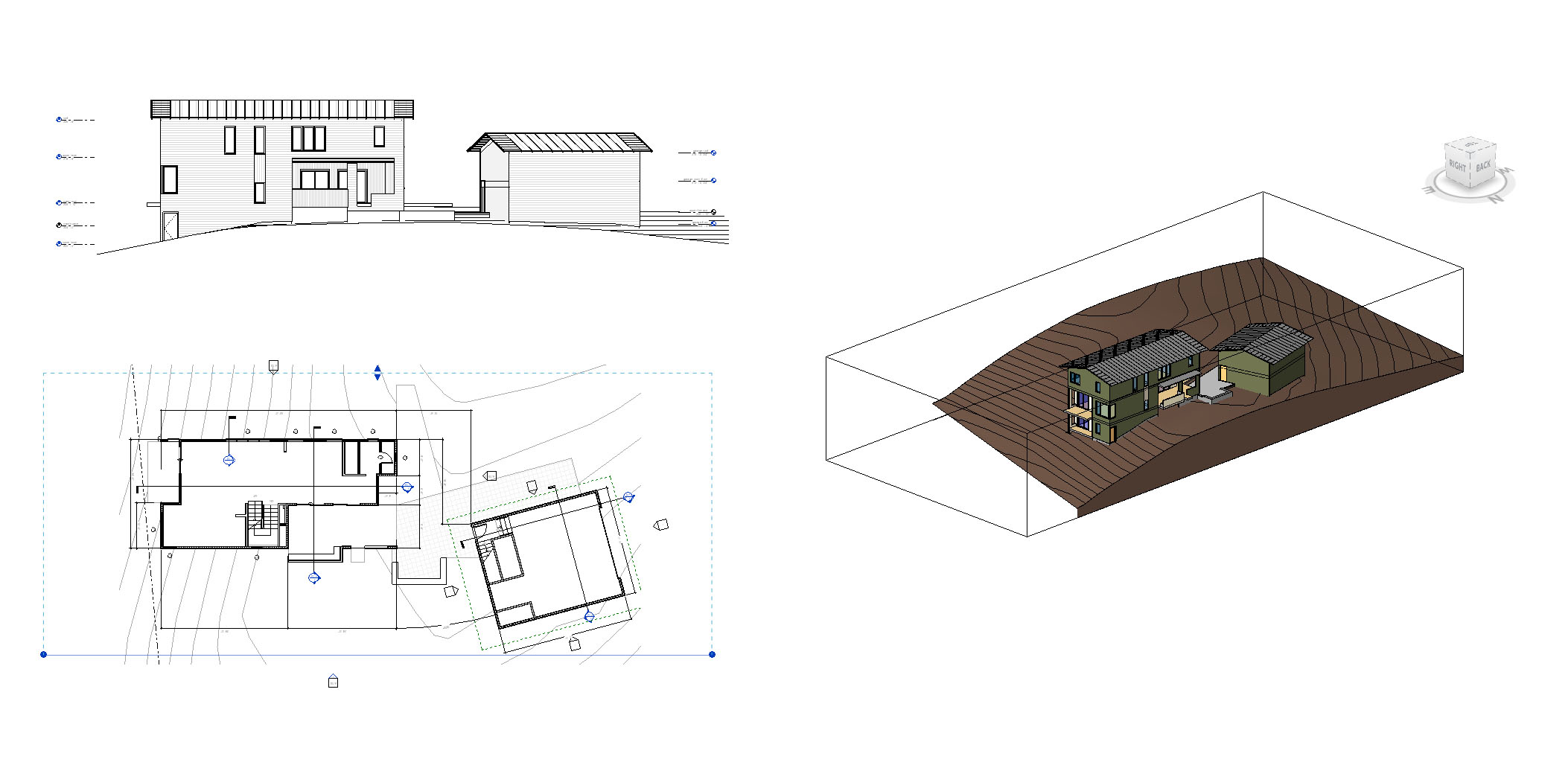

So I'm setting up some elevations and running into a problem:
The site is a topographic surface, and the building is cut into it. The building shape forces the elevation view away from the face of the building, and when I move it away it shows more of the topo than I would prefer and it ends up obscuring part of the building.
Apart from any obvious criticism about sloping a grade towards a building is there a way to correct this graphically?  Please take a look at the attached image.
 Thanks
Wed, Nov 4, 2009 at 4:45:43 PM | Cutting Elevations in Topography
Instead of using a building elevation, use a building section.  you can split that and drag the split on the one side closer.
