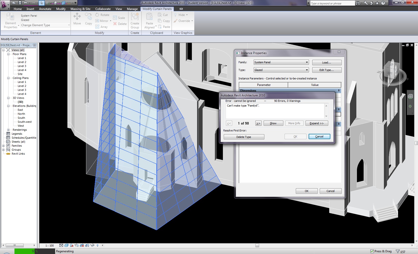

I made a curtain system by face on a mass.  I'm trying to replace the glass panels with a custom family I made.  When I try to switch them, I just get an error saying "Can't make type".  To switch panels, I pick one, right-click and select all instances then in the properties I switch for my custom panel.
Here is an image of what I am trying to do.  For now the custom panel is just a rectangular panel with an edge offset of 50mm towards the center of the panel.  Eventually it will be fancier.

Maybe your offset, makes your panel is too small in some ocasions..... looks small in top
 - 50mm offset  = if panel is 80mm - 2x50mm offset = -20 = error
