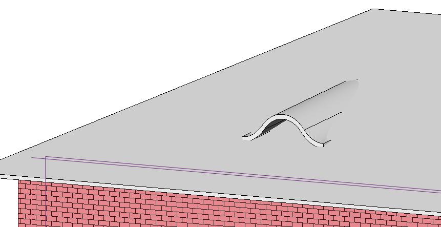

I am trying to create an eyebrow dormer.  See the attached pdf.  I can create the correct profile by extruding the roof but I can not figure out how to get this shape to slope up along the extrusion.

I have never used a blend but I am not sure that it is necessary.  This shape is very similar to a barrel vault except that it slopes upward along its centerline.  I have attached a roof that I made by extrusion, which has the correct shape.  This would be perfect if I could rotate it about the front edge so that the ridge was sloping up at 4:12.  See attached.

I created an in place roof component but could not rotate it from level.  The profile is not a blend.  It has a constant section that just diminishes as it penetrates into the main roof deck.  Any other suggestions on how to create this roof?

I guess I am getting hung up on the “blend” part.  If I understand correctly, when you blend, you transition from one profile to another.  That is not what is happening on an eyebrow dormer.  The dormer profile only curves in one axis.  The lines running back to the main roof are all straight.  Otherwise you cannot get the plywood sheathing to lie onto the rafters.  An eyebrow window is a semi-circular barrel vault that slopes upward toward the main roof.  The profile at the main roof is the intersect point of the dormer and roof.  There is no good way to create the intercept profile without projecting the dormer through the roof.  The main roof has an 8:12 slope and the dormer has a 4:12.   I guess that I could temporarily change the main roof to 4:12 project the dormer and trace the intercept with model lines and then rotate that back up to 8:12 and use the model lines for my intercept profile.   There has got to be a better way!!

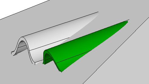

You can rotate the sweep if you unlock it, but looking at the illustration that you posted, the front bit is vertical.  When you rotate the sweep it will rotate the front face also.  A blend can have the same profile at each end, with the front one lower than the other

Same one done with a rotated extrusion - the front is not plumb.
