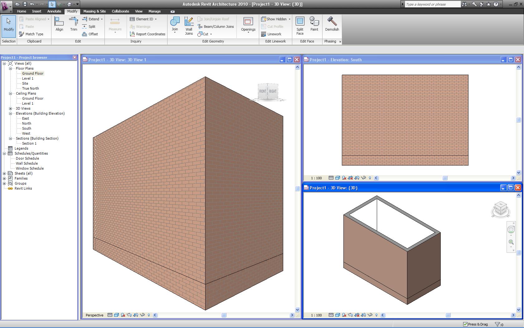

Dear revit gurus, I'm quite new on Revit but I noticed that foundation walls and normal walls [or exterior walls] can't be joint and they always show a line between them in isometric, elevations and perspectives. Using the linework tool wasn't very practical since I have to do it on all the views, one by one. Usually 4 elevations, 1 or 2 isometrics and many perspectives! Stacked walls don't really solve the problem as I have many diferent slab levels, etc... How would you guys do it? Thanks in advance.

Did you try the "Join Geometry" tool??

I did. It doesn't work either.
Fri, Oct 30, 2009 at 9:47:58 AM | Foundation walls & Normal walls joint, linework tool?
Cut a section .... are you sure they line up?  Is the brick in the same zone (finish not core)

Your foundation walls is probably set to "Bearing" and normal walls is set to "Non-bearing".
Set them all to "Bearing" or all to "Non-bearing", or, even better all to "Structural combined" (Instance properties of the wall - Structural)

Man, that was the exact problem. Thanks so much, PedjaCh! I really appreciate. :-)
