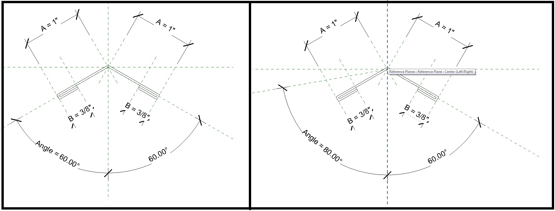

hey guys, I'm trying to make a parametric profile family to be used in in-place sweeps to cap the centre peak of a metal roof. I want to be able to manually edit the angle of the flashing but I can't figure it out. I think I could do it if reference LINES were available in the profiles editor, but only reference PLANES are. I've attached an image of what I'm trying to do; as soon as a change the angle, I get "contraints not satisfied" and the lines loose their association, the reference plane moves but the lines stay where they are. Any advice? thanks.

This that may be helpful to you
http://revit-waterman.blogspot.com/2011/01/profile-families-reference-lines.html

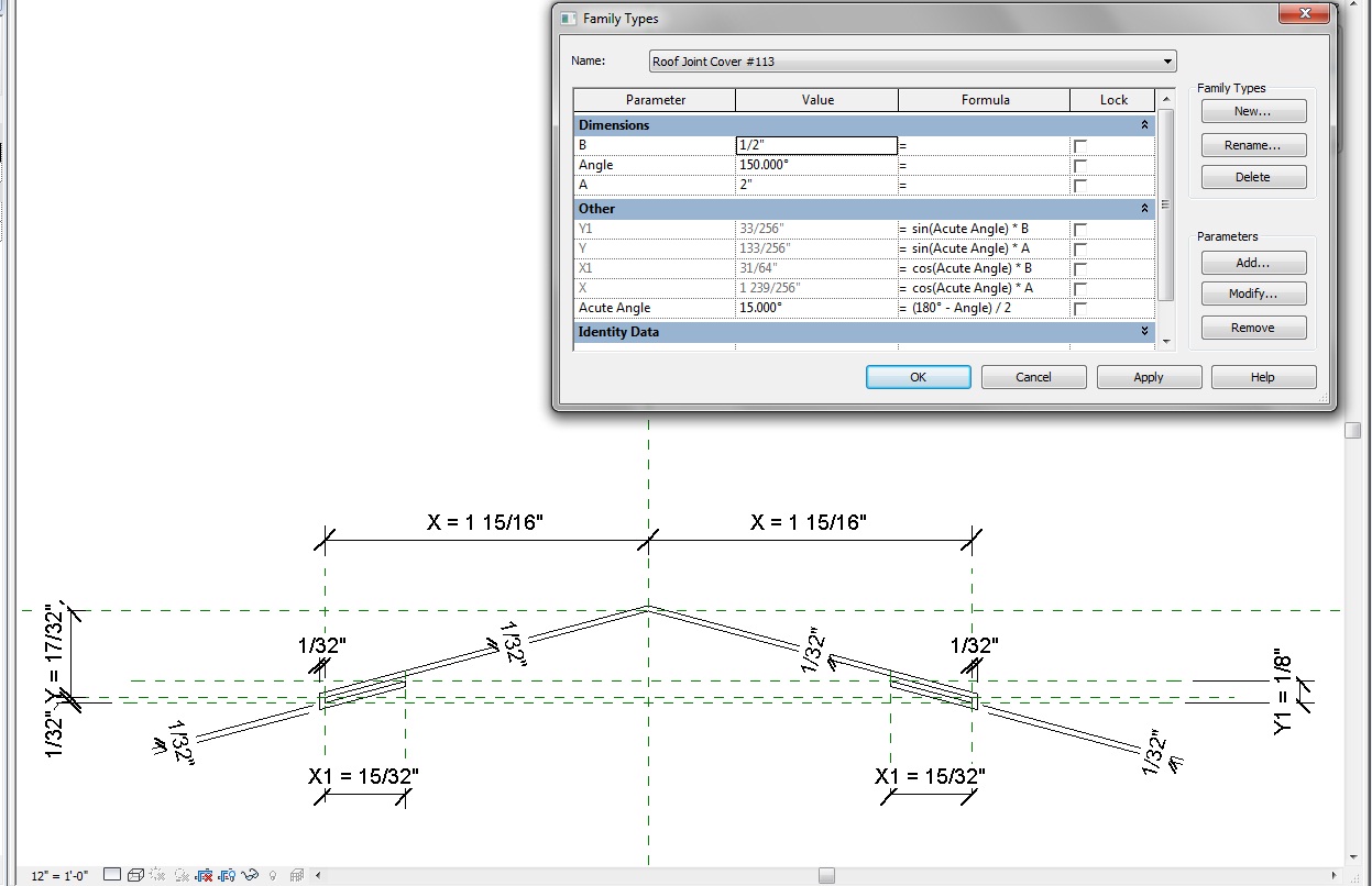

thanks teafoe, this method got me close but not quite there. I still couldn't get the little return on the flashing to work so I went in a different direction. Instead of attaching angle parameters directly to the lines, I made some X and Y parameters and used the angle in some trig formulas. Kind of created a grid.
Thanks for the response though.
