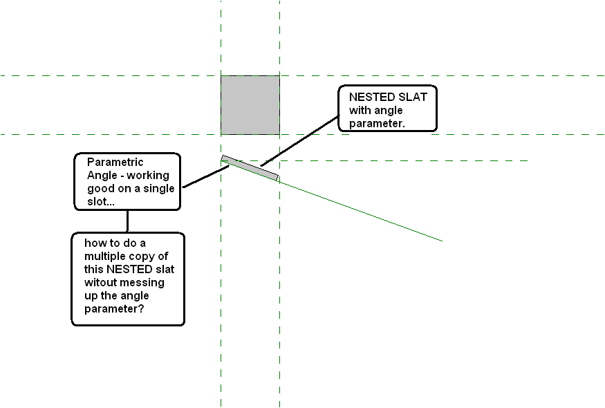

Hello.... I'm having a hard time creating a multiple "slats" on a window blinds family. I was able to flex the slats in any angle but my issue is on how to copy this single slat to complete the window blinds. See attachment. I'm not really good at this family thing! any help would do... Thanks!

Don't think you can but you could array a nested family with an angled slat ... instance based.

ya....thanks! that's what I did. but it's kinda sad that Revit can't nest/array that angle parameter.
