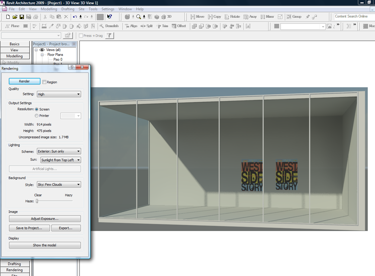

Hi,
 I'm having limited success with using the decal command. I've followed tutorials fine but I don't seem to get the same result as they suggest.
I've attacted an extract of my current render (the things behind the glass that the people are looking at) and a copy of the decal I am placing.
Can anybody suggest why the decal is appearing like it is. To me it looks like its partyl transparent or something but that is set to 0 so i'm not sure what is up.
 Any help would be much apperciated.

Just a question: Did you install the 3 Web Updates for Revit 2009???

you will have to create a model of a box or something to put it on. then make one of the faces its own subcatergory. then make a new material using that jpeg image. and apply it to the sub category and it should work perfect! if you need more explaing let me know i think i know where you can find a video. www.revittotd.com if not let me know.
