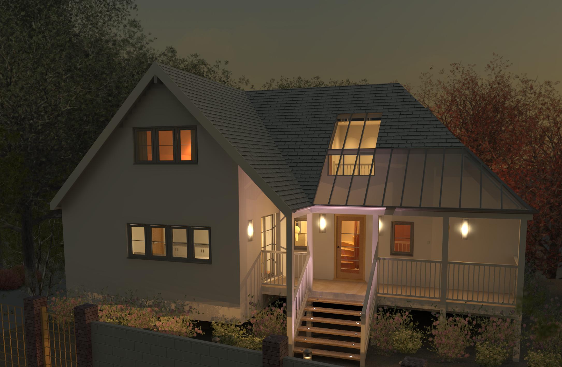

Mon, Oct 26, 2009 at 2:09:22 AM | External Lighting Night Scene
tim123
Joined: Tue, Apr 12, 2005
1310 Posts
4 Stars: 19 Votes
You should be able to do it by turning the lights down quite low and then adjusting the exposure afterwards.  The attached image was set to sun and artificial lights and the time set to about midnight.
