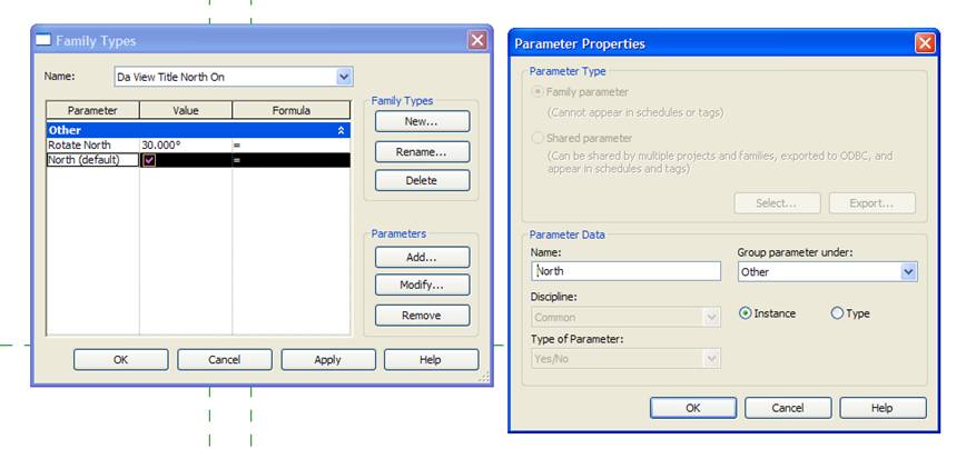

Thanks.  I've mangaged to get it to toggle on and off by selecting alternate family types from the view title type parameter.  However, this toggles the arrow off on all title for the project, not just a particular instance.  I double checked and the family parameter is set for "instance".  Any thoughts?  Revised rfa attached.

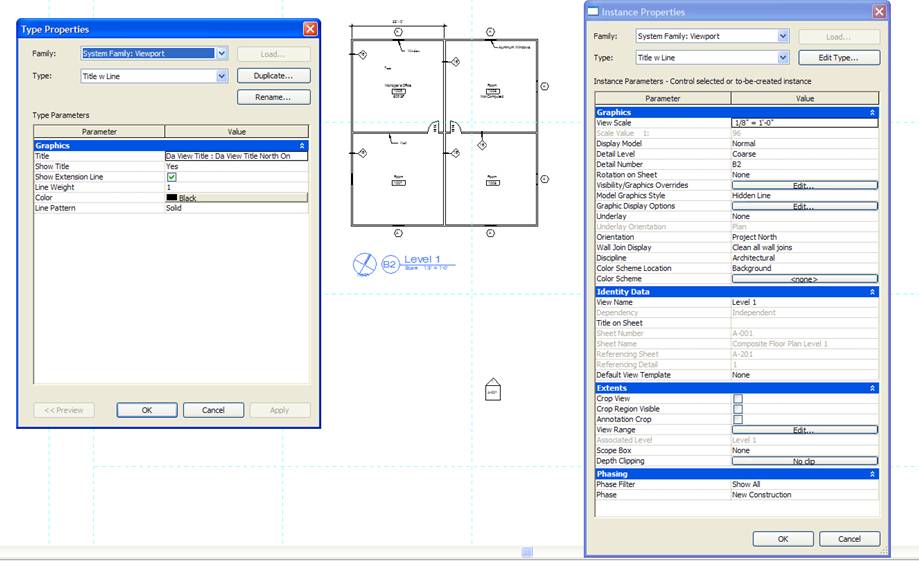

I may be missing something here.  I have the paraemter set for "Instance" as Rstreds suggested (see attached jpg).  I'm haveing trouble controling it when linked with a view setting.  I have also attached a jpg of the setting for "instance properties" from w/in the template file.  If I can't resolve from this post, I'll give up and use a separate north arrow from the title info.

First off, make the instance paramter a "graphic" paramter.
Also make sure in the family, you have clicked the object, and tied the visibilty of it to that paramter. Using the small box to the right of the "visible" field.

ya i would put it under graphics as well, and do like rstred said, click on the arrow and where it says visible, click the box on the right and select the yes/no parameter you created.
