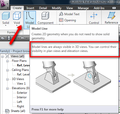

 I created a door family. Started new > family > imperial template > door. I created a simple door. In the family view, everything looks great. Once I load it into a project, I can see the 2d door model lines in my 3d view. Does any one know how to turn off the 2d linework in 3d view.

The lines appear in your 3D view because you use "Model lines" and not "Symbolic Lines", check the HELP menu...
