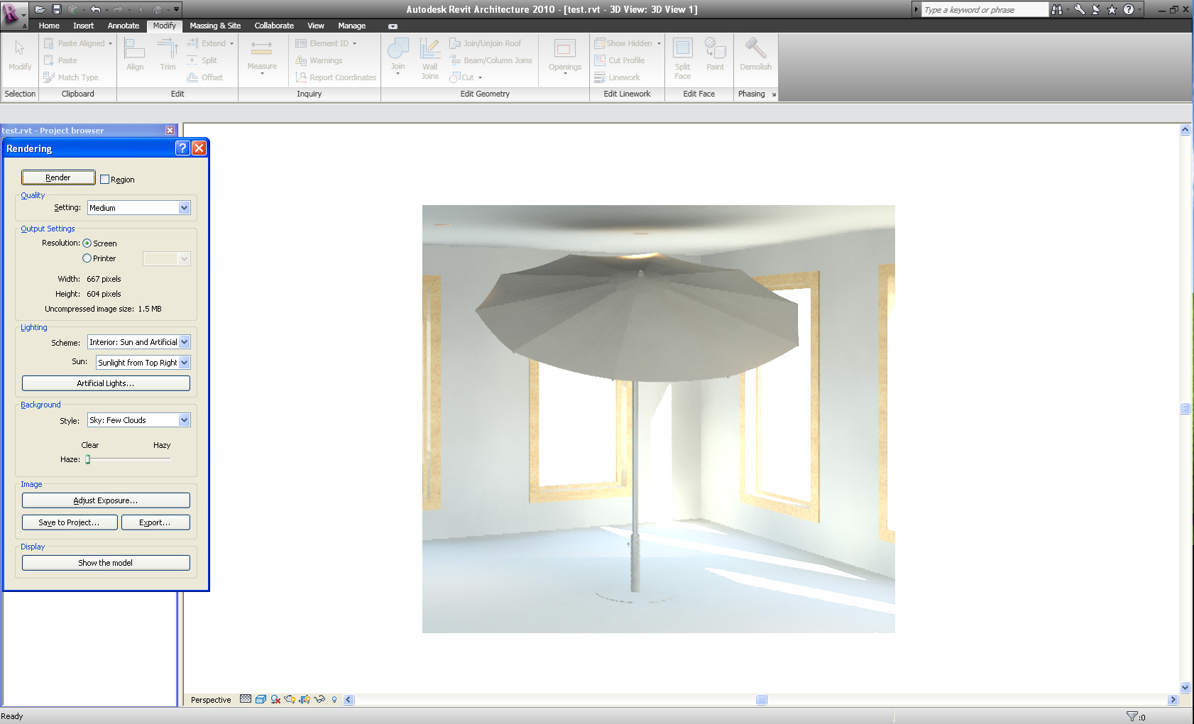

This is my first post here so please bear with me.  I am still having trouble after following this tutorial:
http://revitcity.com/tutorials/how_to_grow_your_family/
I followed it exactly, but when I render, all the materials still appear to be the same washed-out greyish default material.

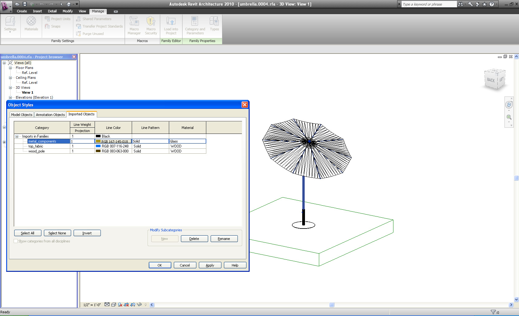

  2. Cad materials are assigned by layer.  In your project, look under settings/object styles/Imported objects/imports in families and adjust your materials.

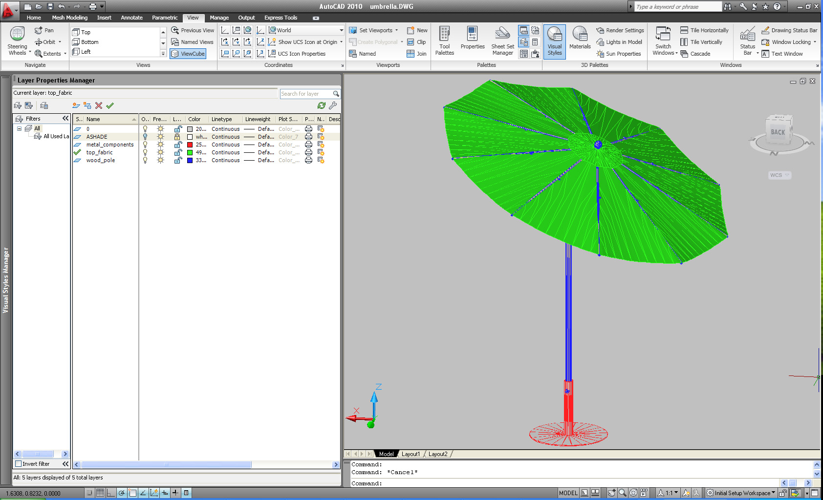

Still not having any luck.  I think it will help to have a specific example.  I have a cad file that is a model of an umbrella.  I want to have a material for the wood pole, the top fabric part, and the metal components.  I included screens, the cad file, and a small revit file.

1) I have changed the materials in the family, and tried adjusting them in the project, doesn't seem to make a difference
2) Tried going to settings/object styles/Imported objects/imports and adjusting materials here also

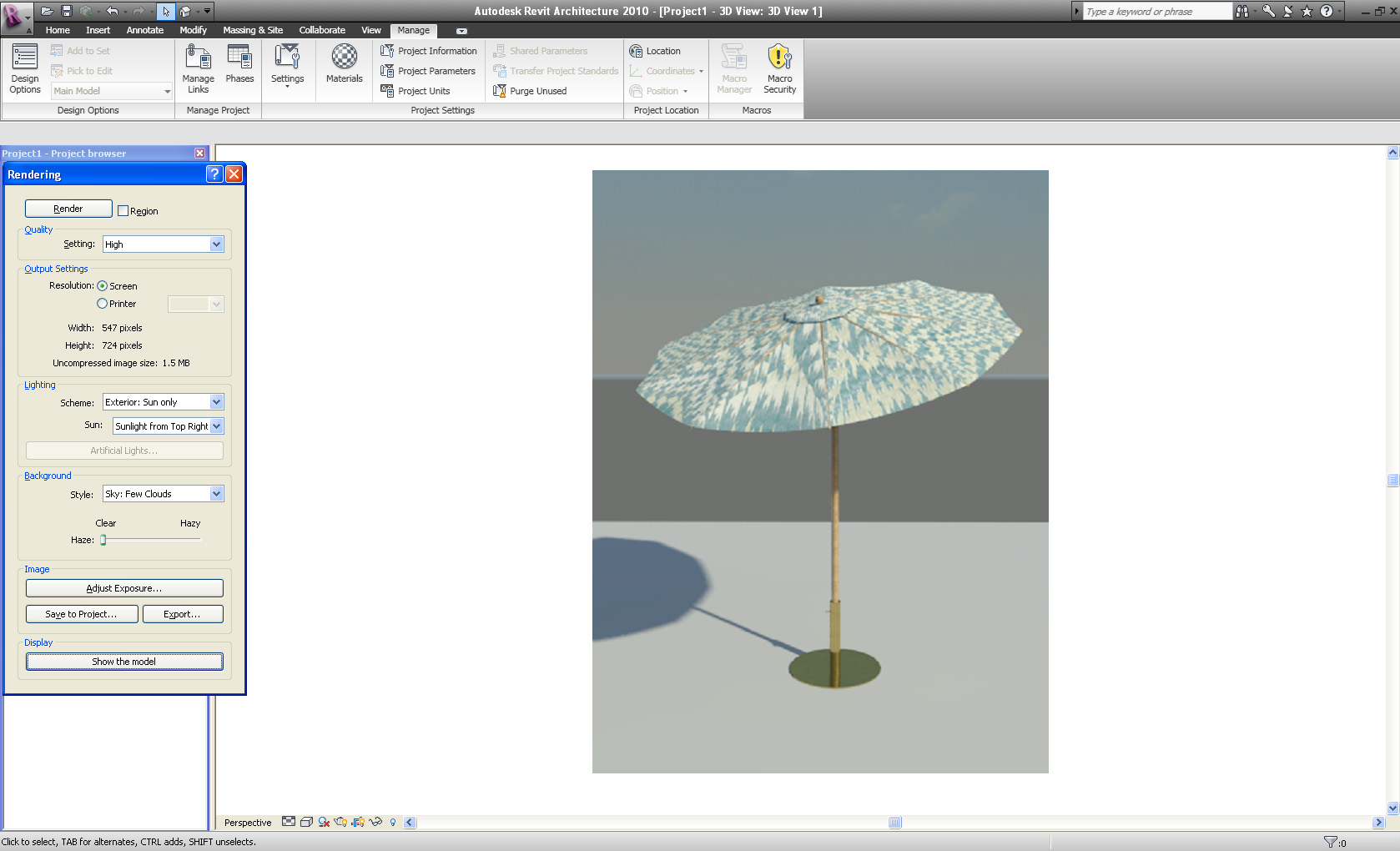

Ok, see the video: http://screencast.com/t/j63SeIje
Mon, Oct 26, 2009 at 4:50:21 PM | Materials / Rendering help
mdrohan
Joined: Thu, Oct 8, 2009
5 Posts
Thank you Typhoon, I am now having success with this.
