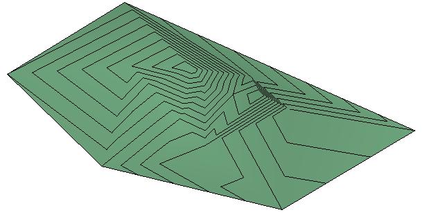

  • When creating a topo from a 3D CAD file, I have noticed when create the topo, all the countours are what I would call "Sharp, or Flat" I have attached a photo to better explain my question, if you will noticed in the picture that from point to point the grades are not "exactly" smooth "or curvy". This is typical with most CAD Imports. However, I have only noticed this when using contours, witch brings up my next question.
  • When creating from a 3D Cad file is it better to create it using the grade lines? or the sruvey spot potins? What is the Difference.
  • I hade also thought of using a conceptual mass to set the points and creat a more "smooth" topo, has anyone tried this or know of any downfauls to this??
All opinion and adice is very welcomed.

Even in most Civil Programs you will get this effect when using points. Use 3D polylines for the contours from the CAD file for you Topo and you will be more satisfied with the out come.
