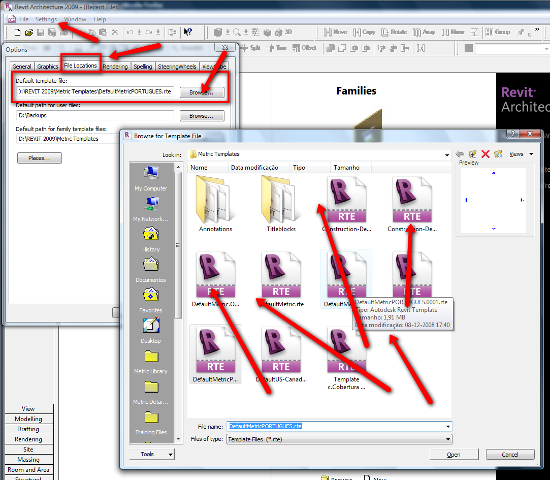

When I open a new project in Revit, the menu automatically defaults to Metric instead of imperial. This also happens whenever I load a new component, it defaults to the metric library. This isn't a huge issue, but it's getting annoying to constantly have to click through several options to get to the imperial stuff. Is there a way to permanently default to imperial templates or libraries?

Go to "Settings" - "File Locations" and choose the template you want, then every time you create a new project it will be with that template....

Yes! Thank you. That was driving me crazy.
