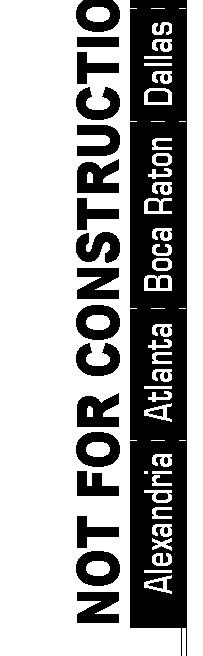

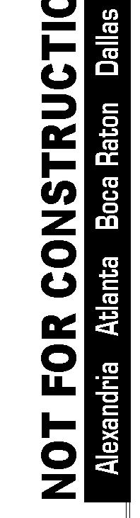

I created a new titleblock and can't seem to get it to look the same when I load it into the project. In the titleblock I have different locations per office that I need to have and then a break between each one. To create this I made a filled region filled solid with black, then created text overtop of it that is white. The breaks between each location are also white. This looks all well and good in the titleblock family but once I load it into the project, I lose the break lines between locations. It seems to be a problem with the draw order but I can't see anyway to edit that once loaded into the project. I've tried different colors and making the text transparent or opaque. Nothing seems to make a different once in the sheet. This line is a new annotation object style that has been created and yes it comes into the porject when loaded. I did try to adjust the object style once into the project to see if this made a difference but it didn't. The first picture attached is the titleblock family that the lines shows up in and the second is once into the project and the line doesn't. Any thoughts would be greatly appreciated.

If graphics become unpredictable, I always use an image (jpg) on your titleblock.
