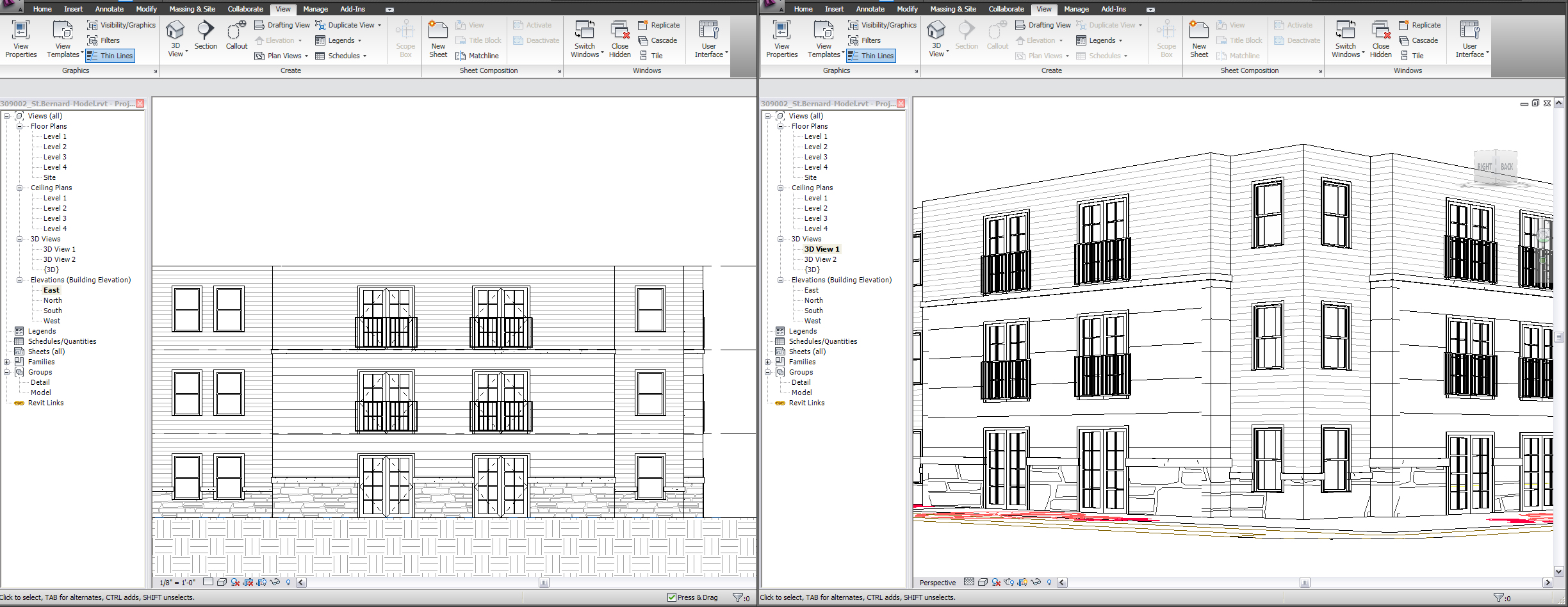

My material hatches on my walls appear correctly in my elevation but when I switch to my camera view for a perspective, two of the hatches double in size and one stays the same.  Has anyone else experienced this?
Tue, Oct 6, 2009 at 3:07:29 PM | Hatch Scale in 3d Camera view R2010
Your hatches need to be 3D hatches (model) not drafting.
