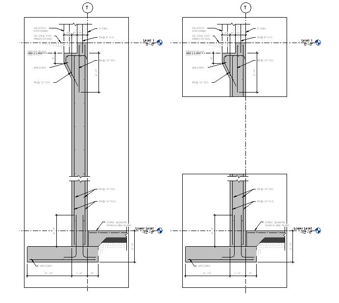

I've created a few wall sections that show 2 floors and the wall in between. I need to be able to break the section around the middle to cut out unnecessary information and shrink the size. Attached a sketch showing a section with the wall I need to trim. I tried using the "Horizontal View Break" on the crop region but I couldn't find a way to bring the 2 halfs closer.
Any ideas how to accomplish this? Thanks!
Tue, Oct 6, 2009 at 9:45:31 AM | Section Break/Crop
Click on the view limits in the section view and a up/down arrow will appear in each portion.  Grab that and move that portion up/down.  If you get it too close, it will "heal" itself back into a complete section.

I figured it was something simple I just wasn't seeing. Never noticed those arrows. Thanks for the help!
