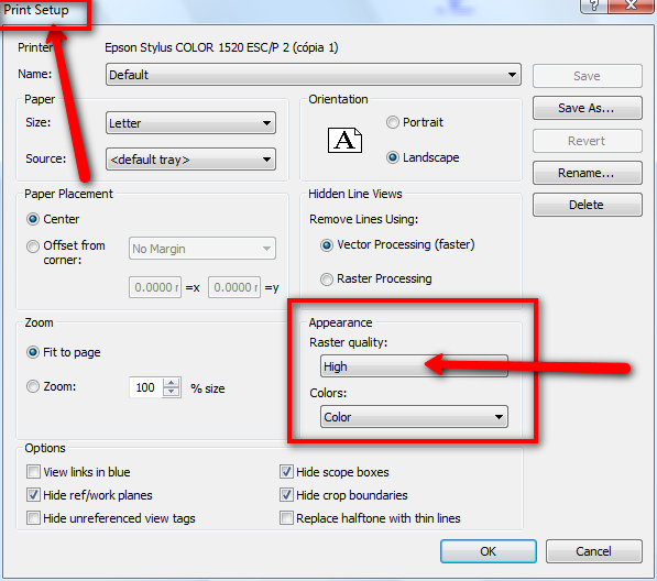

So when I plot drawings from AutoCAD, text plots clean and crisp.  When I plot from Revit the text seems to be sloppy/inconsistant - the line thickness changes slightly.  I thougt maybe if I plot to PDF from revit and see how that goes, the text gets worse and little dots begin to show behind the text. Any curved letter/number does not show curved, but instead a series of stright lines, as if I needed to regen in AutoCad or something.

Did you check the "Print Setup"?

Are you plotting raster by chance?....
Can't expect clean lines if you are doing a raster plot

I always keep the print setup on high, I even tried presentation to no avail. I originally was doing vector processing and switched to raster looking for some changes, but got the same results.
