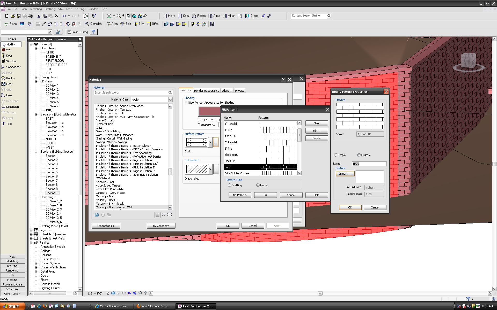

Greetings all. I'd like to post a hatch question to everyone and see you all can come up with. I am doing a model of a historic building on the UVa lawn and need to have a brick hatch follow the slope of the ground. I have walls that head downhill and oddly the masons angled the brick and followed the slope when they built the walls. Currently the model hatch does not allow any rotating of a hatch and setting up a reference plane and aligning doesn't seem to work either. The slope is roughly 6 degrees. Currently using RAC2009.
Any help is always greatly appreciated.

What do you mean you can't rotate the model hatch?  If you can't rotate it, it's not a model hatch!

Seriously. There is no rotation option on the model hatch tab. Is it because it's a wall and not a generic model? See attached image.

Your image shows that you do have a model pattern assigned so rotate it in the view.  Read this topic in your HELP:
Rotating a Model Pattern

That indeed does work, by selecting the model pattern and physically rotating it. It works great on flat walls, but these are serpentine walls and they won't accept it. I may have to create a generic model and see if I can do it that way.

Well, I ended up having to do it the old fashioned way. I copied the hatch pattern itself and gave it the angle needed, then brought it into Revit that way. It worked!
