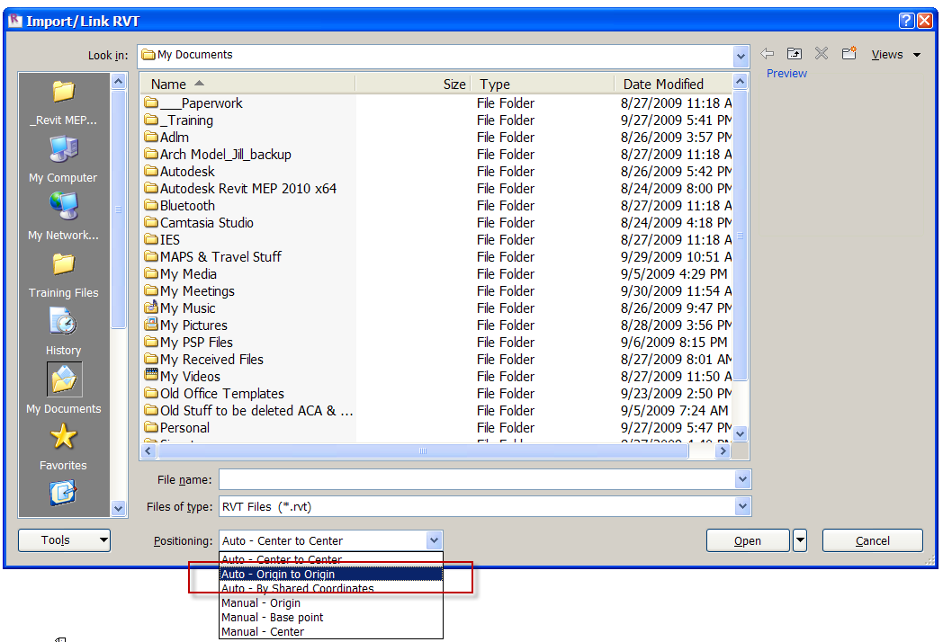

Hi, I'm brand new to Revit and have just started to study it and use it in the real world. I have imported an Arch.link in a blank project using 'origin to origin' but the linked model lands way outside my current work space. I am still trying to work out the relationship between the 'linked' model and the actual structural model.
1. Am I simply tracing over and copying the elements of the linked Arch. model into the structural model and therefore the placement of the linked Arch model is not important? If so do I just relocate the Arch linked model?
2. When an updated Arch. model has been completed down the track, does it have to have the same name and file location in order to correctly be monitored for changes.
3. Should I be using my own datum levels or copying and monitoring the Architects?
 Help would be much appreciated as I have been using cad for 10 years now and this is a massive learning curve for me.

Hello, when you link a file you can specify on a pulldown at the bottom of the Import/Link RVT dialog to link Origin-to-Origin.  That is almost always the most appropriate method of linking.  Origin-to-Origin lines up the origin of the architectural linked file to the origin of your project.  I would also recommend reading up on the subject of Shared Coordinates in your Revit help, and discussing the use of project coordinates with the architect.  Since they start the project, they can define the project coordinates and MEP and structural team can simply "Acquire Coordinates" in their projects to match the coordinate system of the architect and all disciplines project's will line up.  Another benefit is that when you Acquire Coordinates you also acquire the "True North" of the architect's project.

FYI - Origin to Origin is Revit lingo for 'insert at 0,0'
ALWAYS INSERT ORIGIN TO ORIGIN is my best recommendation whether it be CAD or RVT files.

To answer your questions though:
1.  Linked model location is IMPERITIVE when using BIM software.  Always insert Origin to Origin.  Typically in our firm we begin most projects by importing the Arch CAD background or Arch RVT file.  We ALWAYS insert Origin to Origin.
Why this is important?  Firstly, it's BIM's great capability to provide 3D coordination.  If your models are not aligned, you've taken that away.  Plus, it's just a pain in the curse to realign misaligned models.  Also, if you are working in Revit, and Arch is working in CAD, it will ensure that youre AutoCAD exports share the same coordinates as AutoCAD.
You'll probably have to relocate your project, which is an arduous task.
2.  Copy/Monitor does not work that well, but I believe the answer to your question is 'yes.'
3.  Copy but don't monitor the Architects datum elevations.  Create your own datum elevations as need.  Copy, but do not monitor the Arch Grids.  Revit is not a silver bullet.  Coordinate elevation and grid changes as you always have- talk it out.  Do NOT rely on Revit to do this for you.  Don't expect other users to use the tool effectively.
