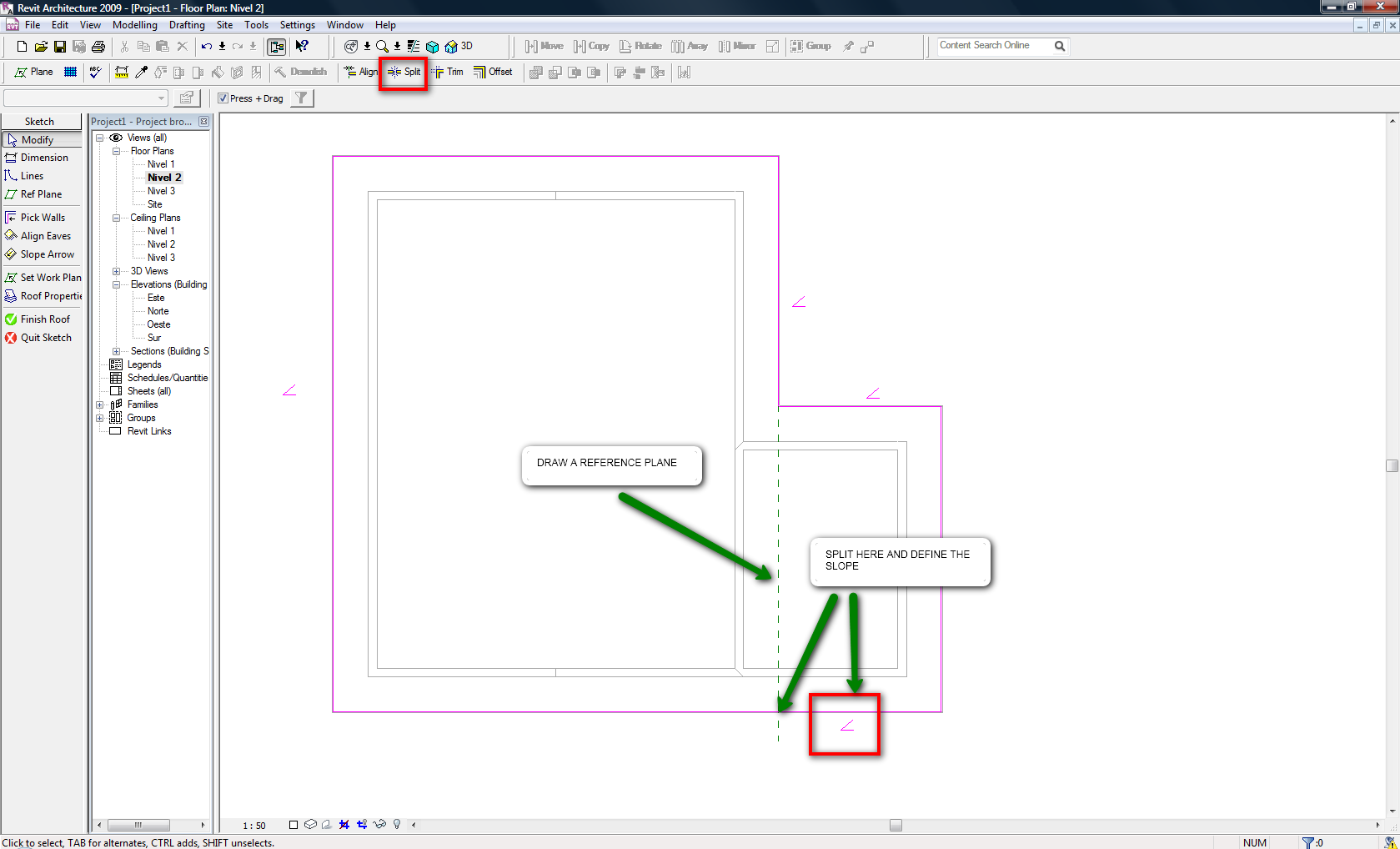

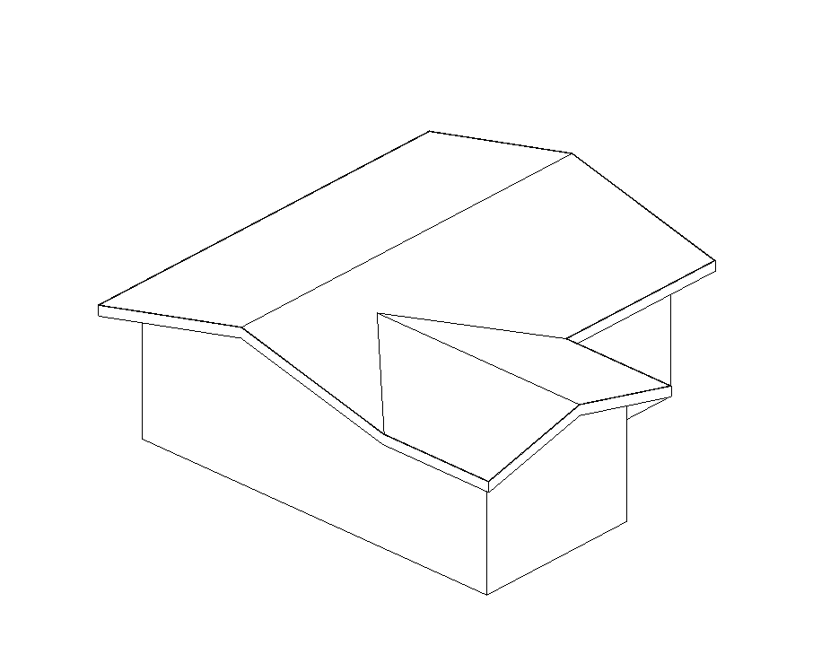

Here is a Revit roof question;
I am trying to attach two new gable roof to an existing roof  I used cut geometry and join roof none of them seem to work. I used roof by footprint but that does not seem to give me the roof configuration that I am looking for. There fore I created 2 gable roofs and trying to joing them witrh existing in between and get the results that you see in the attached files. The attached file shows the gable roof to the right that I am trying to attach the gable roof with higher ridge in the middle. As you can see from the section I am not sucessfull in achieving joining the two. The third gable roof to the left I did not try to join it, hopefully I will with somebodies help
Thanks
Sudanhafif

About the roof to the right, it is very simple: draw a reference plane and where they intercept just use the split tool, see image shown. About the second roof, I'm not fully clear with it,,,,
