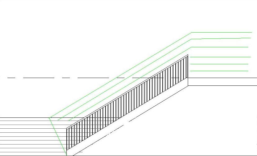

I'm trying to modify my wall surface and make it follow a path make by my stair stringer. Can anyone help with this. attached in a JPEG of what I'm trying to do.

Create the wall, pick in the wall and "EDIT", change to the shape you want....

Well, now i'm looking your image, is that green lines sweeps or reveals? can you please explain a little bit what you really want to do?? Images will help....

it suppose to be a multi level stair which the tiles follow the stair enclosure. the wall has a sweep which is the striaght hort. lines, the green lines represent the path that i want the sweep to follow as it goes from level to level. see the attach pdf, i drew a iso/elevation so you can see what i want to do. any help i get is better than nothing. thank you for your suggestion before.

Use "split surface" tool paint bucket to apply material/pattern.

thank you guys for your help, i used the split face then the paint tool and it looks the way i want it. at first it was hard messing around with it but it worked.
