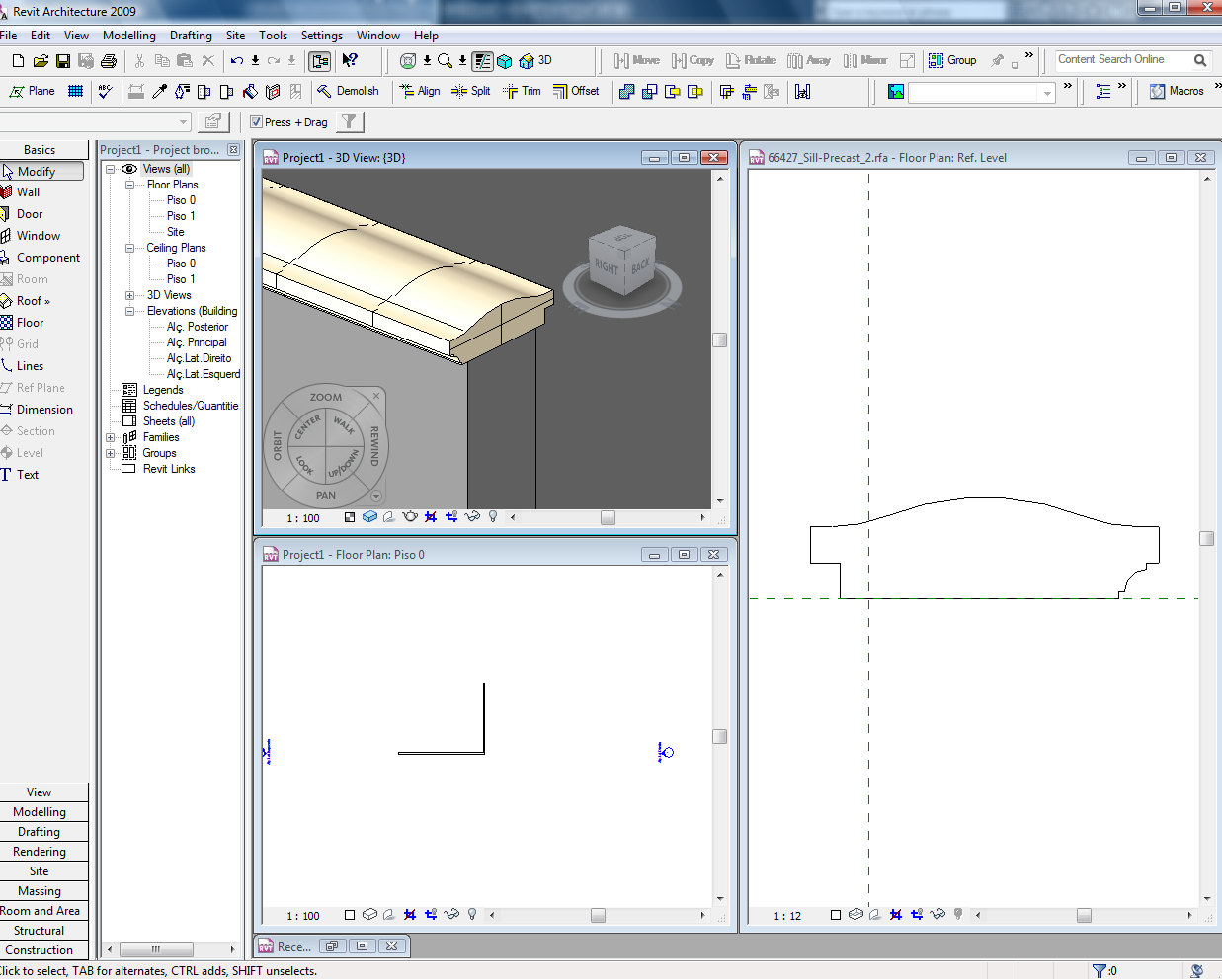

Ive drawn this new profile (nothing more than drawn out), and saved it to my profiles folder, but when i load it into my drawing to make a sweep along the top of a wall to create a coping there is nothing there in the profile plane.
 what else is needed to make this work. I dont need it to change shape or size, just this one instance.
here is the profile

Ive also made the settings for type a "wall sweep" now it shows in the project but doesnt let me finish the sweep. says it cannot create sweep. Arrrgggg. if I change to a generic profile for the path its fine, but when I choose my profile for the sweep the box comes up and says it cannot create sweep. delete elements?.
Mon, Sep 21, 2009 at 1:56:38 PM | profile sweep help
When U created the profile, did you assign it to the correct category? Within the family editor - settings / category and parameters - pick the correct usage.
Then in the project, you have to create the sweep type and assign this profile to it.

Delete and create a new lines....

Typhoon! thanks. What the hell is the difference though?!!!! How do you draw another without erasing the first?

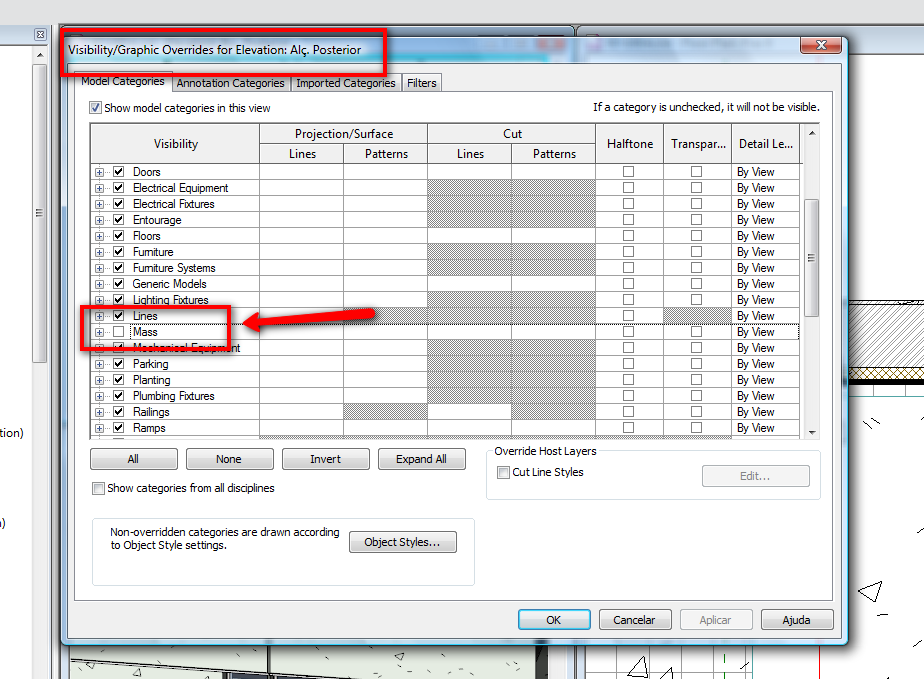

The mass Hid itself after I created it in my project, I dont know why. there it was ready for finish mass button to be hit, when I did it disappeared and I found it and unhid it after...weird.

Go to VG and check if you have the "mass" turned off, if so turn on....
