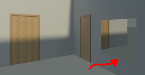

To make a mirror family, start with the 'generic model wall based' family template and  just use a sweep for the frame and the box (medicine cabinet) and make it what ever material you want.
The mirror part is just a rectangular extrusion (thickness of glass) and make the material 'Mirror no tint'' from within the 'materials' dialog box.
Then load the family into a project, get a 3D view of it and then 'render'. You will not see the full effect until you render it.
See image attached. The mirror has no frame, just the mirror. I also atttached the basic family file.

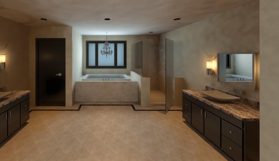

Thank you so much for the information. I did find one  on the site and modified it to fit the project.  I have attached the image. I would appreciate some feedback. It is rendered in Revit Architecture 09 at 1000dpi. This is the second one I have done in this program. I do not like to go from one to the other and wish Revit was better at importing other files accurately.

That.... Is.... Awesome
BTW, I hope that chandelier never falls into the tub!

ya...don't hit your head when you stand up. Very nice.... I like the chandelier too - is that model or photoshoped?

Your rendering is nice, but 1,000 dpi?  10x too much really.  Even rendering for a glossy magazine print is like 300 dpi.  Most web images are 75-150 for good ones, and 96 or so for "just get it done".  Turn that dpi down and watch how much faster it goes without much visual difference!
