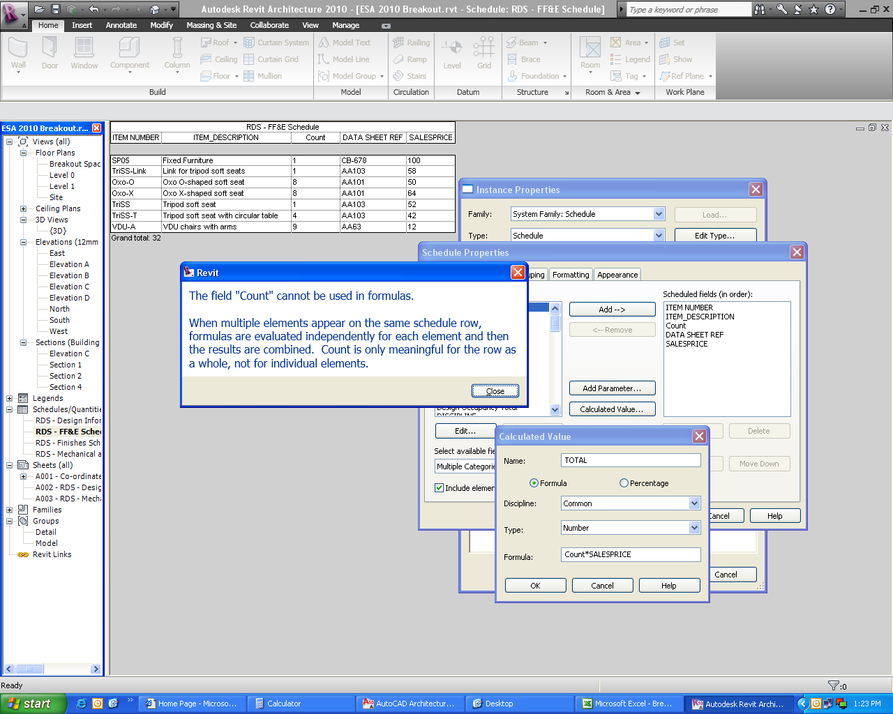

I am trying to get the TOTAl valur from my furniture schedule but its giving me error that Count parameter cannot be used in Formulas.
See attached snapshot for more help.
Thanks

To be more precise.
I have created a TOTAL parameter by clicking Calculated Value. Now i am trying to put in formula Count*SALESPRICE
Hope this helps to understand

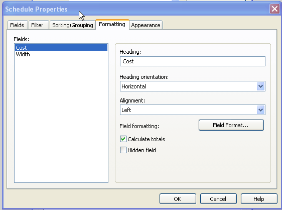

You don't need a formula to get what you want.  Under farmating, just check calculate totals for the field.
