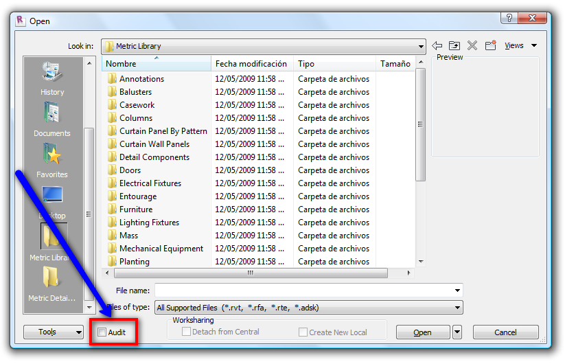

While trying to open a drawing I received the following error message - 'an attempt was made to access (job file) has passed its end'When I click the ok tab nothing happens.It seems to be happening to this drawing file only. Does anyone have any idea how to fix this so i can access the drawing again?

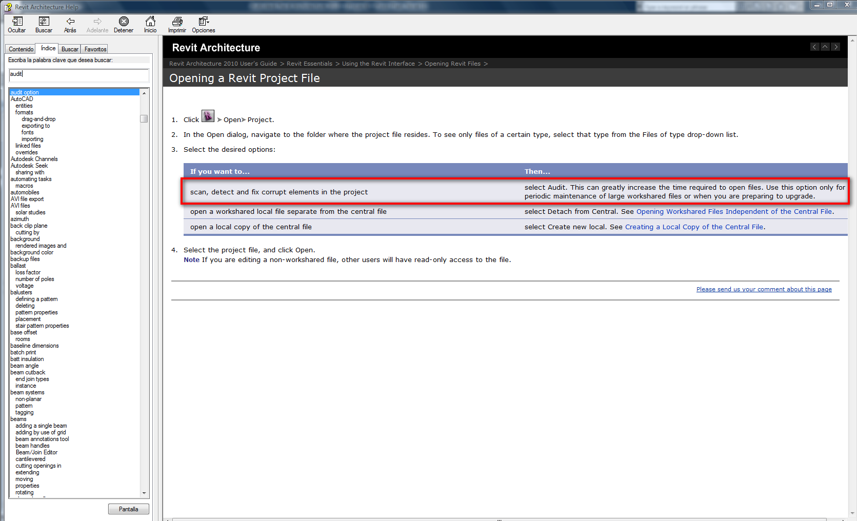

Did you try to "Audit" the file when you open???

i was working off a USB stick and when i tried to reopen the drawing the message came up. i cannot open the drawing in Revit now. what do you mean by 'Audit'?

Audit-------->
