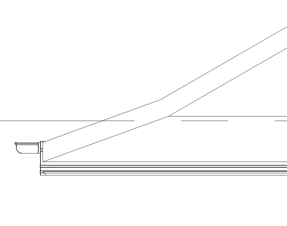

Hi Mr Spot, That's what I thought. It should be simple. I have attached a part plan showing the roofs over a walkway connecting into a pavillion building, 3D view to help clarrify what the roofs are doing and a typical section through the eave. The eave as you can see is a split pitch to the main roof. I created the eave using a fascia profile element and then created a custom gutter profile to attach to it. All of these elements whether they are part of the pavillion roof or walkway roofs sit on the exact same pitching plate height and all with the same pitch. I would like the roofs to be joined to represent what will actually happen at these junctions(there is no ceiling) and also to get the fascias and gutters to mitre correctly. At the moment the fascias and gutter run through each other at exactly the same position. I have tried forming the roof to the walkways as one sketch but Revit thinks this to difficult to do and stops generating the roof. I am forced to create the walkway roofs in a number of parts. Your guidence is appreciated. cadjockey

Hi Mr Spot, I tried opening the file you attachd however there is a compatibility problem. I am using version 7. I tried creating the roof this way the very first time. What I found was that the roofs did not miter correctly at the change of pitch location in section. Especially when I set the visibilty to fine in order to see the structure. This is when I created the fascia that would attach and show the roof changing pitch at the wall plate. I am please with how the gutter has worked though. Our office designs alot of tropical resorts with intricate detailing and roof designs. Hence my wanting to be confident that revit can handle the roofs we require to create. If you could send your file again it would be greatly appreciated. Thanks for your time and patience. cadjockey

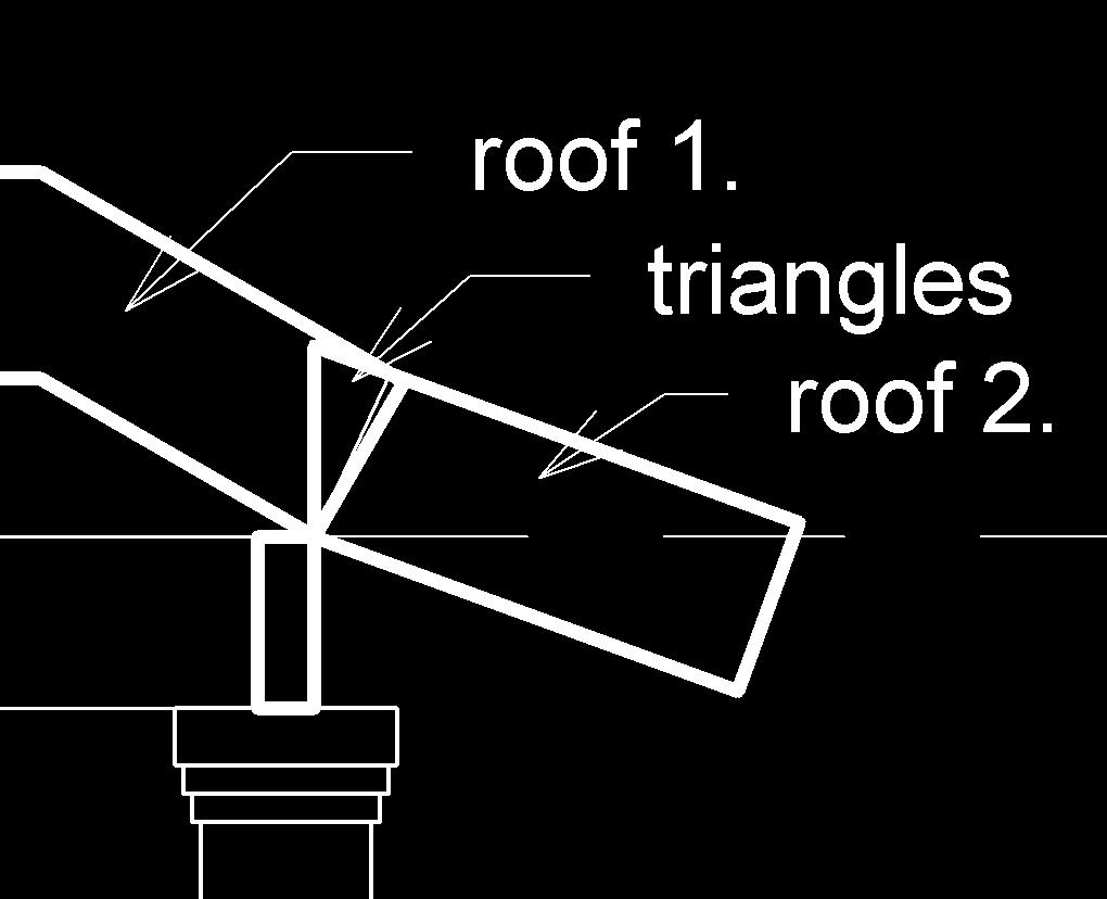

Hi Mr Spot, I am able to create the two roof sketches and have them overlap at the pitching plate. In preparing the void sweep so that I can have the two roofs mitre correctly I assume I open the metric_mass template in the family editor. Select >void form>void sweep and create the sweep for one of the overlapping roof parts using the section view of the overlap to correctly sketch the shape I need. Save this new family in my project. (there will be two separate triangular sweeps to do the job) refer attached image. Open the section view showing the overlap of both the roof sketches. I get lost at this point. When I click the cut geometry tool the cursor changes however, I am unable to select anything. How do I impliment the void sweep I just created to remove part of the roof overlap. cadjockey

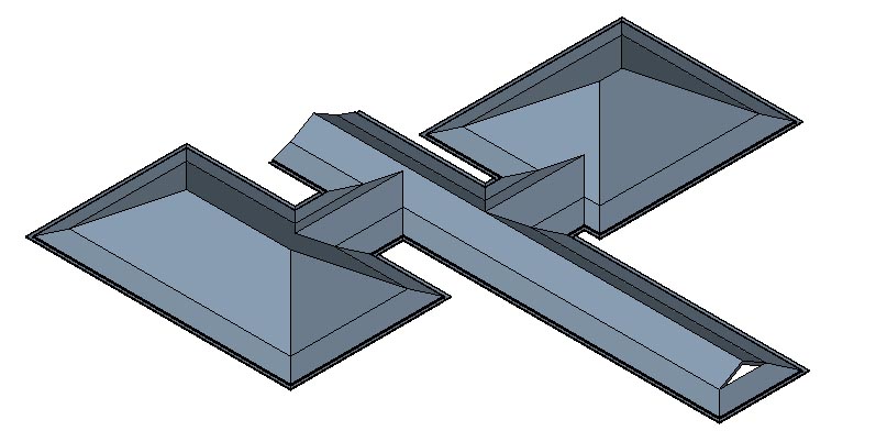

its not an external family, its an in-place family. Follow the exact steps as previously outlined. Modelling tab-->Create
