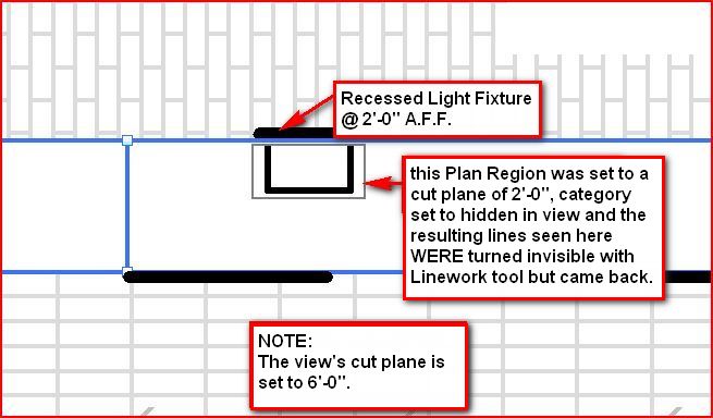

I have PLAN REGIONS along a wall that cut through a component much lower than the cut line of the primary view.  I then Hide in View these PLAN REGIONS because they are not needed in the view.
Because I have PLAN REGIONS along a wall, there are extra lines where the custom cutlines occur for the View Regions that are hidden.
This is where I use the Linework Tool to get rid of the extra cut lines by setting them to Invisible.
The problem is that EVENTUALLY the Linework reverts back to the category and is no longer invisible, so I have to go back periodically and turn that linework invisible again.
Any thoughts or suggestions??

please refer to the attached image.......

You can control the visibilty of plan regions in VG under annotations, plan regions.

SOVLED:
I ditched the plan regions and edited the family that I needed to view.  I took an invisible line and drew it from the bottom reference to above the cut plane height.  Now the component is visible in my floor plan.
 This DOES NOT solve the pesky and unstable cut lines left over due to a plan region overlapping a wall, BUT the above solves my specific issue.
