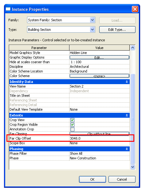

Hi,
Is it possible to set the default value for Far Clip Offset in section line properties?
See attached snapshot
What i want that if i generate a new section it should have 3000 as default value for Far Clip Offset - Is it possible?
I know that generally this value comes from the extent of the model.
Any suggestion would be great help.
Now on the implementation stage....
Wed, Nov 18, 2009 at 1:26:22 AM | FAR CLIP OFFSET - DEFAULT VALUE
gprakash
Joined: Fri, Apr 24, 2009
49 Posts
This may not be a straight answer :-) but for the given requirement, what i would do is to place the section mark at approximately/ nearest to 3000 from the model extent and in line with the required location and just drag the section mark to the desired location.
If you need the Far Clip Offset exactly as 3000 by default, let us wait for the appropriate suggestion.
