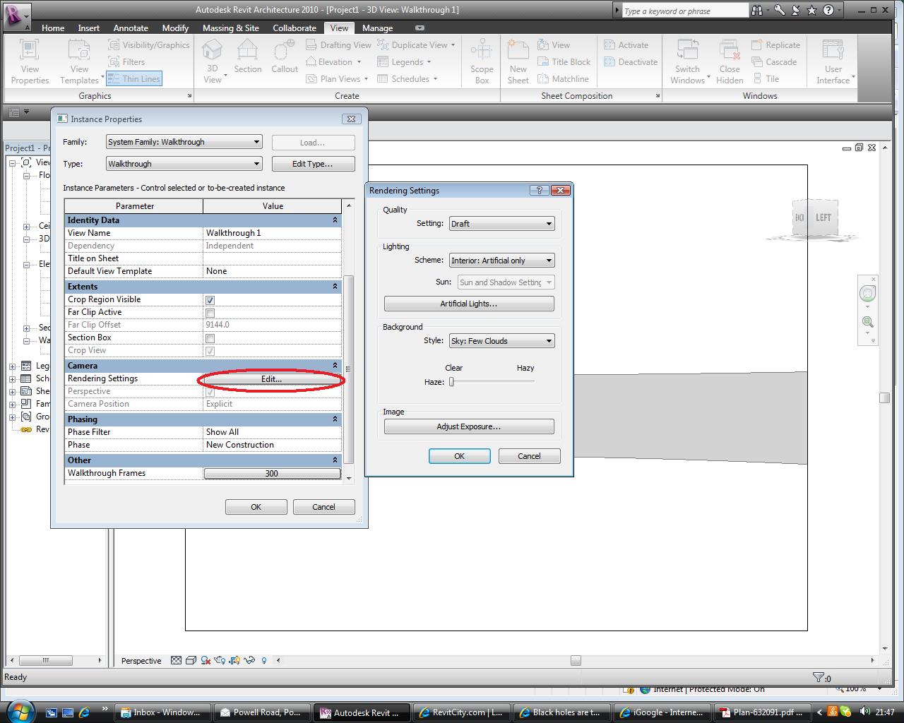

When I render a still scene with the camera, obviously I can turn on interior lights as well as adjust the sunlight position.  When I export a walkthrough I cannot find this option and am getting all black images with an occassional window.  The default sunlight is on-  where do I switch to interior lighting.

I'm using Revit 2009 exporting to AVI

Go into any of the render frame view properties.  There is a Render settings option.
