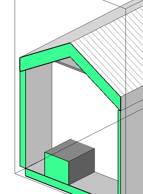

Section Box through wall is solid Blue hatch.  How do I change the color of the section in the interior of walls being cut through in the section box?

The walls use the material 'poche' in course 3d views.  You can change this in materials, under settings.

Well its not jsut the walls.it is everything cut by the section box...its like a blue poche..

Everything in the cut section uses the material 'poche' in course 3d views.  You can change this in materials, under settings.
