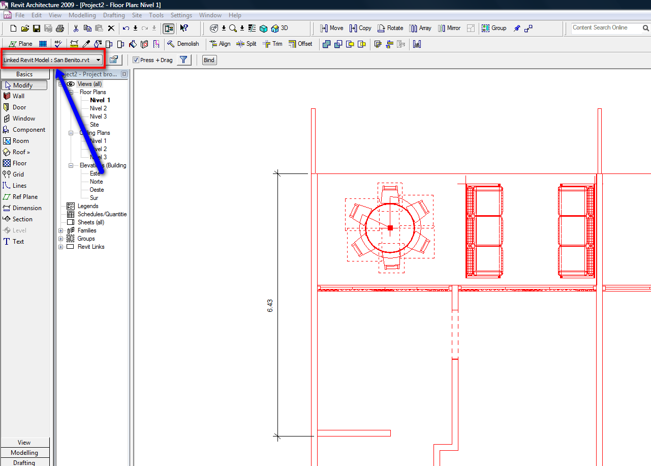

I am working on a townhouse project and  created each unit as a linked revit file.
Now that I have put it all together
and toggled the visibility setting just the way I need it I can't get my dimensions to snap to the walls in linked files properly.
I only can snap to the core center line of the linked revit file,
but I need to be able to snap to core faces of walls in linked elements. How do I do that?

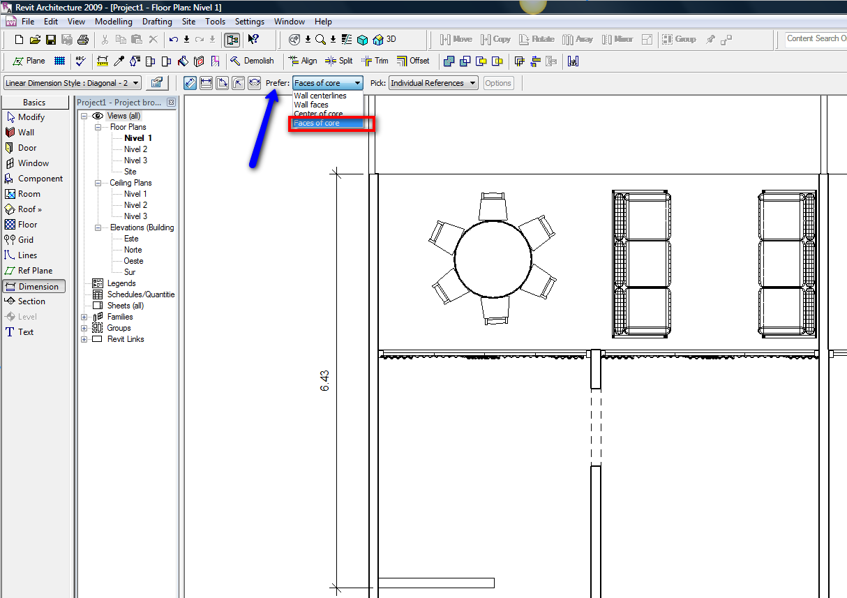

On the Options Bar, for Prefer, select Faces of Core.

Nope, that does not work with linked files.  I tried again both in RVT2009 and RVT2010. Could it be that this is a bug?

When you select the wall, use the tab key to cycle through the faces until you get to the one that you want to dimension to.

"Nope, that does not work with linked files."
markuspirker: in the example I posted before, I used a linked Revit file and didn´t have any problems even without the need of selecting walls with the tab key....

I could also select the faces with the linked file with faces checked.
