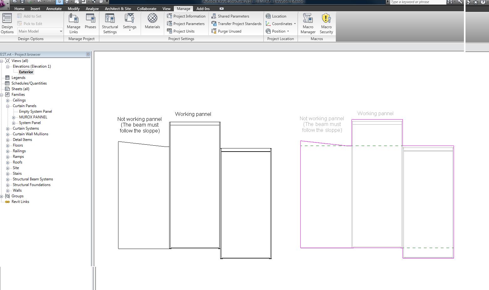

Hello everyone,
I am trying to create a curtain panel familly with an head component (W8x10) inside the familly that follow the angle of a curtain wall when I sketch a wall profile. Is there any way to constraint the head component to the Top plane ? I've tried many options like defining the Top plane as the work plane of the girder but nothing's working when I sketch any angle at top.I got the message Can't make type "MUROX PANEL : STD".
Tank you for your help.
 I've jointed the familly file MUROX PANEL.rfa you must import it into a new projet and create a curtain wall system into wich you use this curtain pannel.
