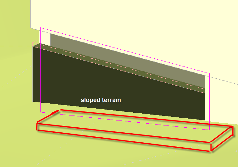

Hi all,
Is there a way to create a foundation wall with a sloped base-line? We use it here because the soil is rock, so the foundation will be poured following the soil/clip.
If a adjust the foundation wall with "edit profile" and change the base line sloped, my foundation slab dissappears, so is there a special way to do this?

Thanxs for the reply,
Maybe the slope is a little exagerrated, but they do this over here, image building on a sloped, rocky island, they are not going to break the rock, they pour the concrete [thick enough] in parts and start leveling the concrete blocks block for block [island style].
Inplace familys are not my favorite, they are not parametric and interactive, meaning i have to draw this for each wall! Isn't there a foundation wall that could be referenced to a plain or something! Otherwise the inplace family

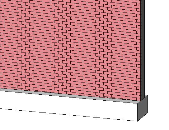

Thu, Sep 3, 2009 at 1:57:36 PM | Sloped terrain and sloped foundation wall
tim123
Joined: Tue, Apr 12, 2005
1310 Posts
4 Stars: 19 Votes
You could create the foundation as a wall, and edit the profile.  The image shows a 700mm wide concrete wall as a foundation, with the edited wall base aligned and locked to the foundation wall.
